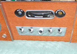

Hi Michael,
It's been a while, but I'm pretty sure you can pull the tumbler out of the old switch and install it in the new switch. Unless that is the part that failed...
Looked at an old photo. Yes, the tumbler can be removed.

Greg--
Yes, I have since learned that you can simply change the lock portion from any one to another. Since it is the switch body portion of mine that is broken (one of the screw-in terminals cracked and will not allow me to get the contact to come tight resulting in an intermittent connection to, amongst other things, the fuel pumps) I will fix it as you suggest. I have another on the way.
