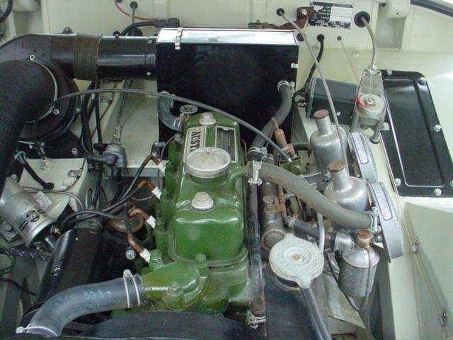

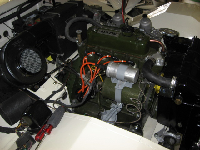

Not a great picture, but... you've got a 1500? Pretty sure this is the stock position, coil facing inward toward the engine.
Wire end of coil faceing toward engine and down a bit so water does not collect in it.
This for Bugeye or early midget. Second pic for later builds.
