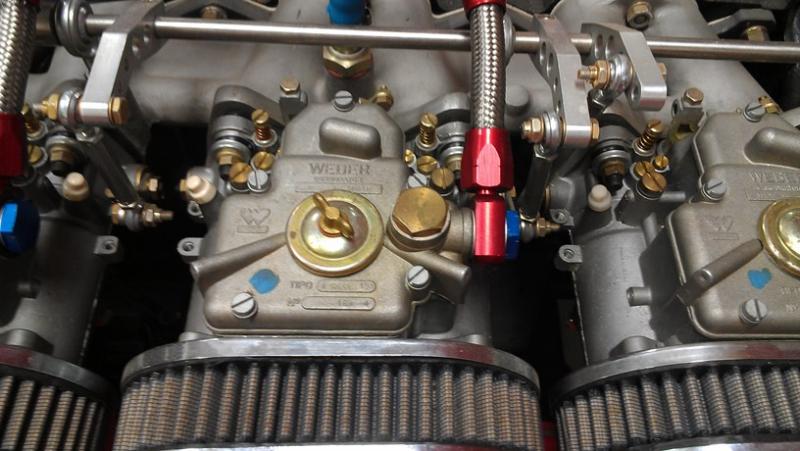

On the Weber DCO family, out board of the jet cover (the round bit with the Mickey Mouse ears headed fastener) are two raised areas with stamping to indicate Type and Number. See attached picture and look to the right of the blue mark on the middle carb. There several models of the 40DCOE with single digit designations such as 40DCOE2, double digit designations such as 40DCOE12 or 40DCOE18 or triple digit designations such as 40DCOE106 or 40DCOE151.
The inlet horns on the 38 and 40 DCOE do indeed position and hold the aux venturi in place. This is not the case on the 45, 48 and 50DCOE. Regardless, you should run the inlet horns on the larger carbs as air flow through the carb and minimization of reversion is the function of the horns.
As far as aftermarket conversion kits that used the 40DCOE, the most common are the 40DCOE2, 40DCOE18 and 40DCOE151. As far as current aftermarket availability, I think that only the 40DCOE151 is available but in the back of my mind seem to recall that the current ones are Spanish production.

Tybalt, thanks for that! Among the Lotus folk there is not a lot of love for the Spanish DCOE.
