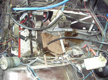

Several weeks have gone by now and I thought I'd update on the Rover Conversion. All parts are accounted for and the motor is still being rebuilt. By the mid march I should have it back and ready to install. The T-5 looks like an easy mount with only a slight Trans Mount. I have attached a pic of the engine out. Really not too tough of a job as I did it solo, my friends weren't allowed to come play that day.

Sorry, gents been away awhile for a variety of reasons but here is the latest on my Rover swap. I can honestly say I hope never to have to go through this swap again for a variety of reasons, some having to do with the car's design and some with the sense of urgency from my engine shop. Anyway here goes:
Despite what our pals across the pond told me it became quite obvious after the motor was out that some chassis tubes would need to be redone to facilitate the motor mount brackets. This is being done in early July at a race fabbers shop. Welding round tubes is a job left to experts so even though I have a pretty stout mig setup, I didn't think I was up to the task so out it goes.
My engine shop here is very well known for building Nascar motors and is very busy. There 3 month promise has turned into six months but at tleast it is now done. .010 overbore, everything else was good and we added a little cam. It goes on the Dyno next week and we are expecting about 225 HP. The once the fabber is done, then it off to the exhaust shop, the driveshaft shop, then back for wiring and I should be back on the road, maybe late August?

Just an update in case anyone is interested. The Engine is in the car. I needed the help of a local fabrication shop because the fellows from across the pond were wrong, this was anything but a bolt-in swap. Unless you take the body off and do major frame mods, this is almost impossible. Luckily, almost impossible means that it is just doable. On the flipside that means it will cost more.
Anyway to make a long story short, it will be done at the fab shop by 8-15 and then it is just wire it up and Go play! I will have a pretty detailed article on it in the TVR Times but I will definitely not recommend anyone else doing it unless they are willing to shell out some serious $ or they have some serious fabrication skills!
