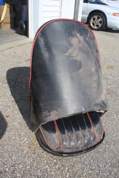

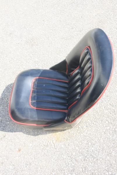

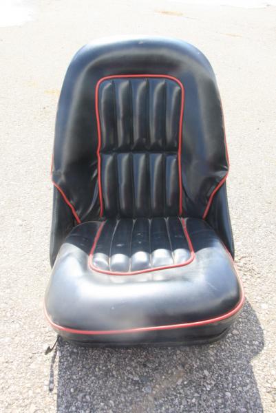

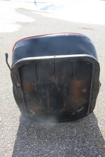

Even though I'm still light years away from finishing, I dragged out the seats that came with my 57. I'm thinking they're possibly AH 3000 from the catalog pictures I've seen, or maybe something else. The covers are decent and the pans are good but the TRF leather seat covers I have will never go on. So how can I find some useable proper seats and who might want mine? Are all the tr3 raw seat frames and cushions the same, or is there a 3, 3A, post 60K difference? 1-seats 001.jpg2-seats 002.jpg3-seats 003.jpg4-seats 004.jpg

You have A/H seats! Either Sprite or big Healey. They will sell on ebay. Best bet is to buy the complete seat set on ebay for $800. You can't build a set for that.

John is correct. Those are Austin Healey Bugeye Sprite frames. They were also used on the MK Ii Sprite.

The way I can tell right off is the bottom pan of the TR seat is almost a perfect semi-circle at the back. The seats in your picture have a more squared back pan with rounded corners. Also, the seat back on the TR's is almost perfectly round...and once again yours have a straight section at the top. You can see these differences when you compare your seats to the one one Ebay.

That's the basics. The problem areas on the TR3 seats is the bolt holes in the pan crack. Then, every time the car is left in the rain with no hood up, the seat pans fill up with water. The pans eventually rust through. The cracks are very fixable. The rust through...not so much.
