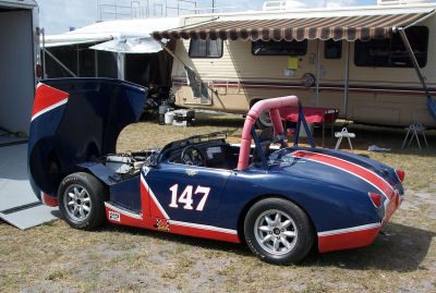

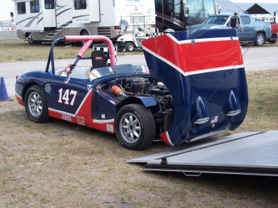

Just thought I'd add these to inspire you Jack (not my car though...I wish!!)!! I used the little rubber hold-down thingies. They are not the "prettiest" set-up, but simple and effective. They also tend to hold the sides in (which have a tendency to splay out a bit!) /bcforum/images/%%GRAEMLIN_URL%%/grin.gif

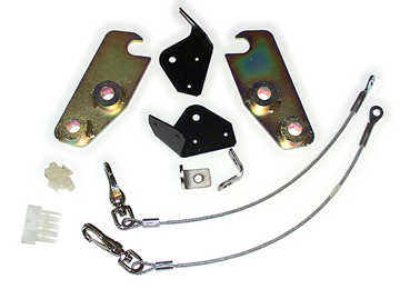

hmm, those are the straps I had in mind, wonder where I could mount them that they were not seen. Thinking.........

/bcforum/images/%%GRAEMLIN_URL%%/iagree.gif That Dzuz fastner set-up is very nice and unobtrusive! I may have to consider scrapping the "Jeep" type hold-downs I have now in favour of that! /bcforum/images/%%GRAEMLIN_URL%%/thumbsup.gif
