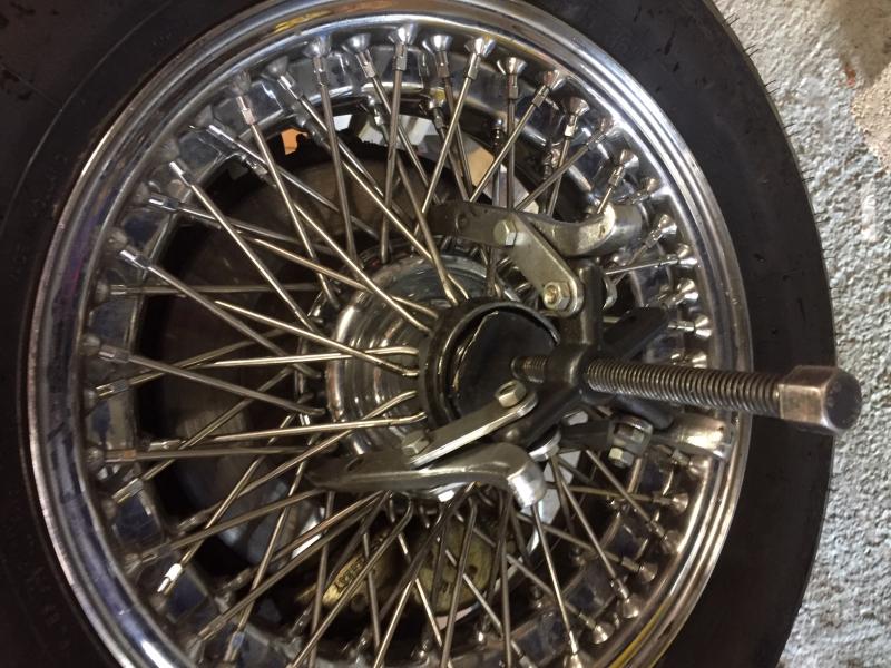

Hi all
Today I got around to trying to remove the two stuck wheels. I used a borrowed puller (from the garage who put the wheels on in the first place) with a small disk of metal covering the hub for the puller to press down on to. The wheel began to move with very little force. I then cleaned up both sets of splines, re-greased and tried to put the wheel back on. Pushing the wheel back on by hand the hub ended up flush with the wheel, whereas normally you can see the first 4-6 threads of the hub. I ran the spinner on to tighten the wheel as much as i dared with the spinner pushing the wheel on further 5-6mm (this what the garage told me they did when fitting the wheels first time round). Needless to say when I tried to get the wheel of once more it would not come off by hand, but came off easily using the puller. I then measured the "spline to spline" diameter of the front and rear hubs and unsurprisingly found the the front hubs were slightly larger by 0.3mm larger than the rear (62.0mm). I spoke to the suppliers who measured a new set of hubs and got pretty much the same readings. They tried putting a new wheel on both front and rear hubs, which went on and off with no problems. Returning to my workshop I took the brand new wheel from the rear and but it on the front, where it slid on easily. Likewise the old (but an unused spare) wheel slid on to the rear with no problem. I repeated this for the other side.
So now I have four wheels on four new hubs and all are easily removed. All I can think is that the old wheels (bought when I lived in the US) were made to higher tolerance (only fitting on the 62.0mm splines, than the new ones (made in China?) which fitted both the 62.0mm rears and 62.3mm fronts.
I would have preferred the new wheels on the rears as I was originally advised (as the drive comes thru the rears) and the older wheels on the front, but now have them the other way around. Will this cause any problems? None of the wheels show any slop when fitted.
Thanks
Phil
