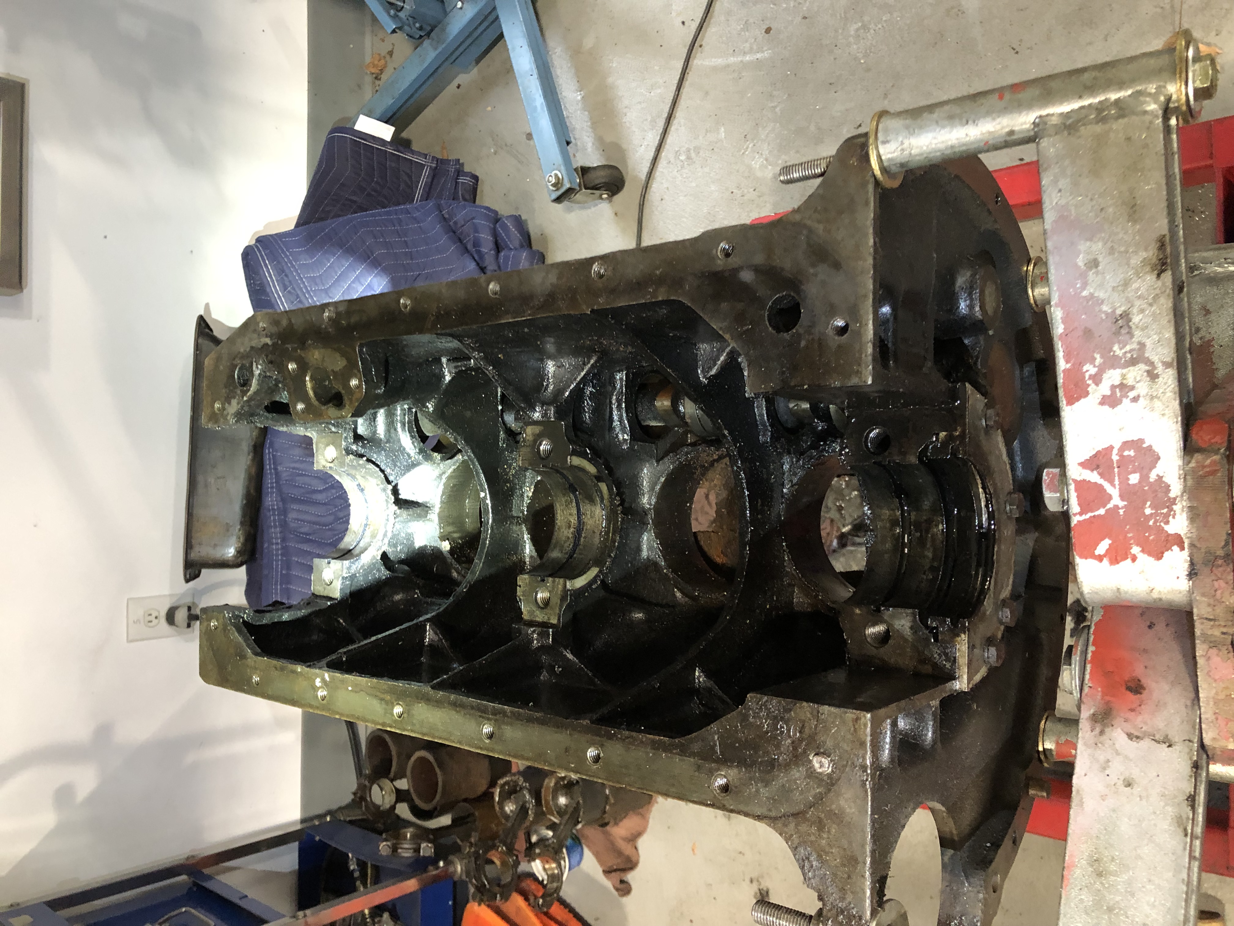

The engine is original and it out of the car but is seized. That will be one of my first projects. I'd like to keep the orignal block. Luckily this isn't my first fight with the 4 cylinder TR engines. I'll get it unstuck, and hopefully the crank and rods will be worth using. If not, I'll go big and build a nice motor for it. Might have to do cam bearings, I'll measure and see.
