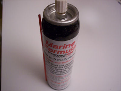

I agree 5200 is pretty robust, 4200 would work but either way there is a product made for removing it! Marine Formula by Debond Corp. (pic. below!).
