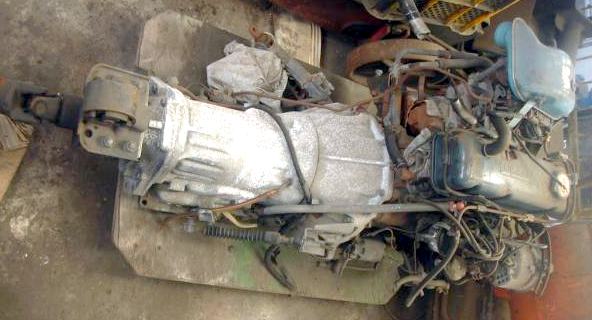

No, not at all. The Auto Datsun trans is huge. You'd have to make a new tunnel and work out various mechanical/vacuum issues. I've worked on a couple automatic Datsun swaps in Morris Minors and it's an ordeal, even in the larger Morris.
