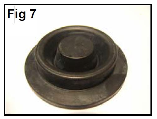

Moss has a seal that theoretically solves this common issue. Part number 582-505, they have info on their website about it. I've purchased one but have not yet put it in service....
Their description:
"We also changed the cap gasket from a simple flat ring of rubber to a complete cover. (Fig 7). There are two reasons: First, we were aware of an annoying tendency for brake fluid to squirt up out through the vent in the cap. This is especially true of the Girling caps (and replacements) which have the two vent holes in line with each other. We off-set the vent hole on the inside with this in mind, but the "anti-splash" seal makes it impossible for fluid to escape. The second reason for using this type of seal is to limit the amount of atmospheric moisture that can get to the brake fluid. There is a tiny slit in the seal that will allow air pressure to equalize as needed, but the seal greatly reduces the exposure of brake fluid to moisture. This will effectively increase the life of conventional brake fluid, and help reduce the damage water can do. (For more information on this topic, see our website for the article on brake fluid). "
That's a Chevy part but it's out of sight so no one will know. I've got them in all my LBCs. Be sure you make a small slit in it so the tank can breathe.
