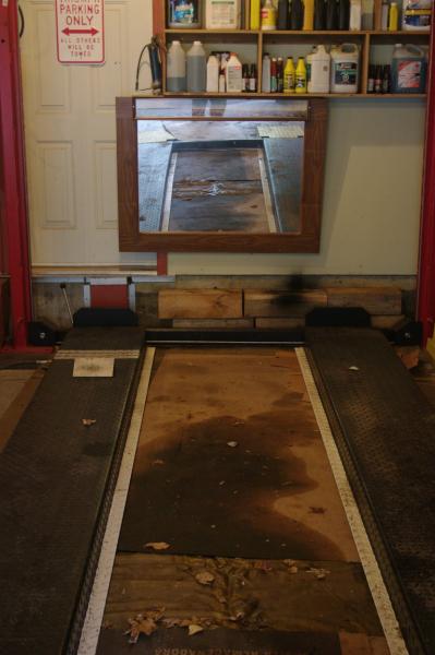

Well I decided on a 4-post lift and could not be happier. Major advantage for me is being able to store 2 cars in our rather prolonged non-driving season. TR6 fits easily, but the TR3 take a bit of care to make sure wheels are properly positioned. I added a large mirror on a bit of an angle and painted the edge of the ramps white. Makes it much easier to drive on with the TR3, and it is useful when other club members come to use the lift :-)
Cheers, Mike
