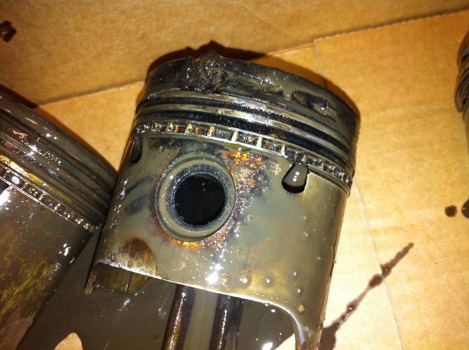

hunk-a of hunk-a of burnng piston
Sopwith_Camel
well for those of you who helped with my posts "slow turning" or the recent "Cardiac" post
well we have striped down the engine and the pistons are burnt very burnt so time for a bore out
and full rebuild.
steve:dejection::sorrow::sorrow:
Well, now you know... :nightmare:
Bummer it's that messy in there, and good luck with the rebuild. Let us know how it goes.
Burned?? Any idea what caused that???
Kurt.
IMG_2647[1].jpgtoo hot plugs
any suggestions on what cam shaft to buy? hot road cam?
That looks like a top compression ring land failure, not that uncommon, maybe the biggest reason to never reuse old std. piston.
yes we are going to bore it out a bit and fit new pistons, and rings and most everything.
