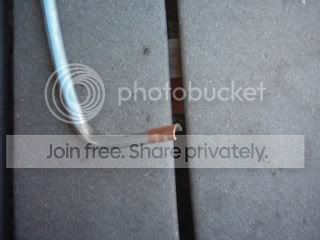

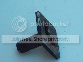

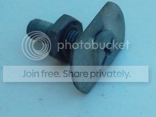

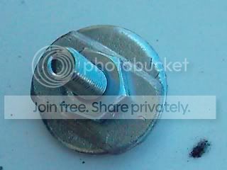

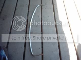

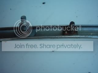

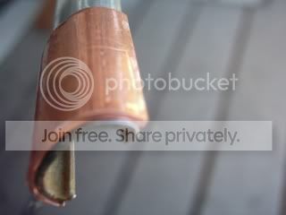

I can`t find the Grill Surround joint clips for my Smallmouth Tr-3, So ....... I decided to try and manufacture some. I started out with a piece of 1/2 In. copper tubing {Water Pipe}
Cut it on one side down the middle and formed to to the somewhat correct contour of the grill surround. Here are some Humble pics of my FIRST attempt.
Eventualy {When I am satisfied at the outcome these will be chromed}
The next feat will be to silver solder on the attaching bolt so it can be bolted to the apron.
More pics to come as progress continues.
Hopefully this will work and look correct. {NOT building a concourse here, but do want the correct look.}
Am I an idiot, or does anyone think this will work?
