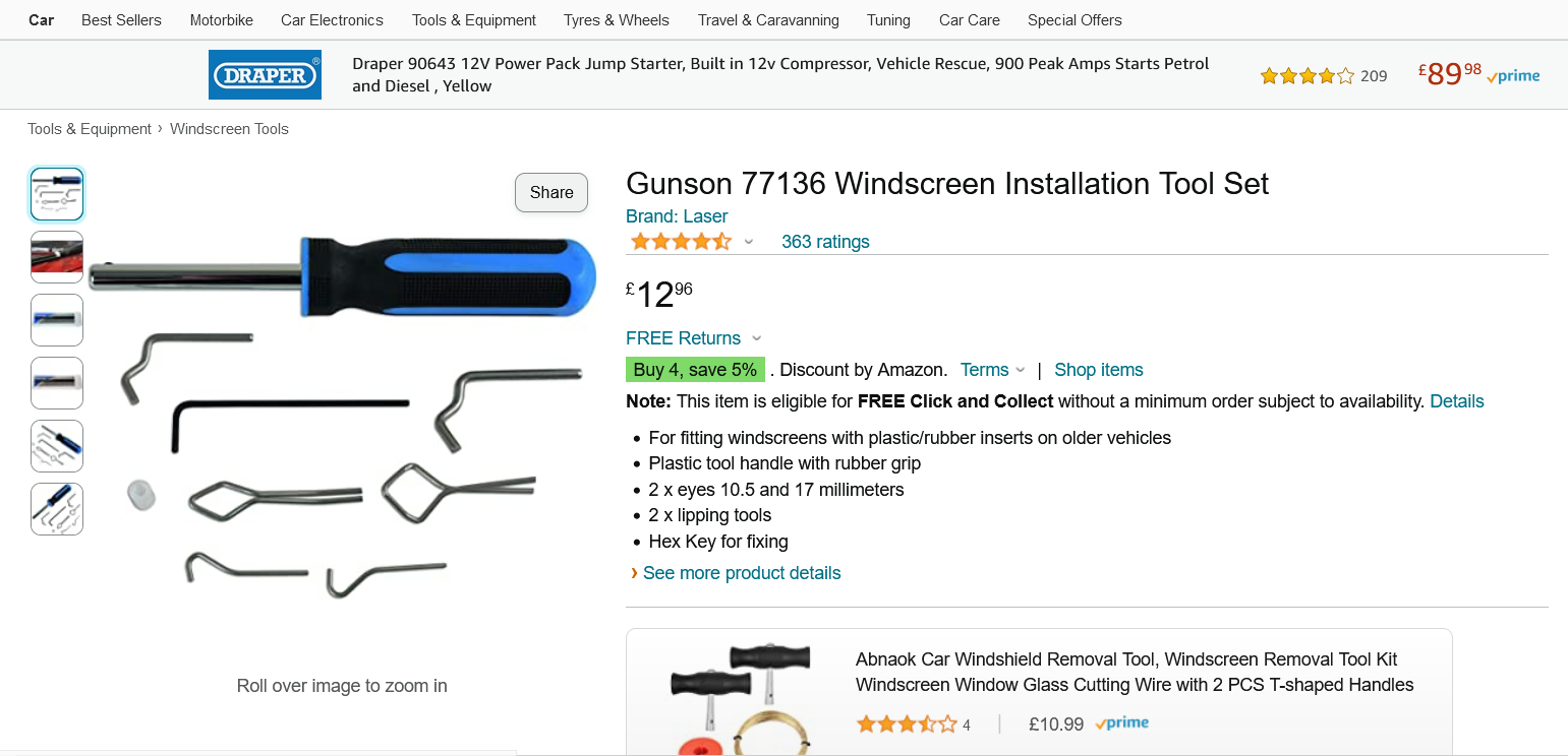

There is a tool you can get for fitting them back in,
just need to use the attachment for the shape of your trim
On my vauxhall the trim went in after the rubber was installed. I was going to buy this tool but found I was able to do it with a small slotted screwdriver and a dental pic or two.
