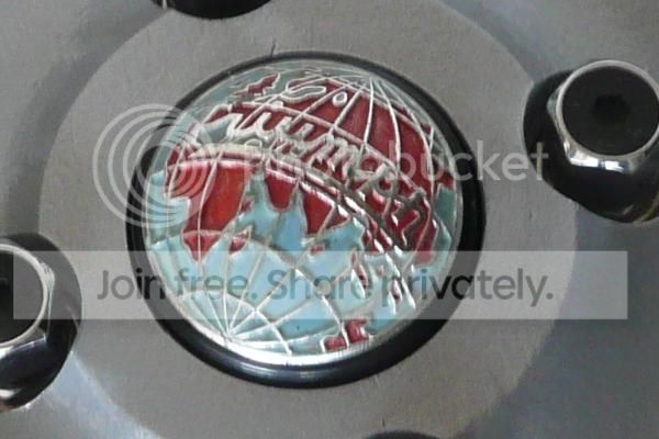

Looking for photo... here is one (though on an alloy wheel, not a hubcap):

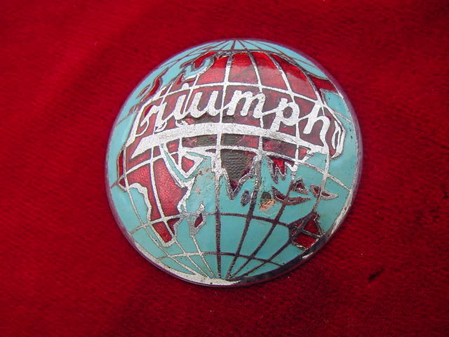

Unless I am missing something, the top one looks like a very faded version of the late TR3-TR4 "painted" medallion. The bottom one is the enamel/cloisonne version used on TR2-TR3.
Geo Hahn said:
I believe the common 'embossed' (not enamel/cloisonne) emblem is correct (used on mid to late 3As and all steel-wheel 4s).
Like this look ... Any idea how that emblem is attached to the alloy wheel? Looks very nice and does not appear to be added to normal centre cap but held there with some sort of rubber ring. Cheers, Mike
Looks like somebody either machined a nice attachment for it, or was able to retrofit an existing center cap. EDIT: Geo-is that what you did for your JA Pierce wheels?
This type of add on is highly dependent on the wheel used, some need to move out to avoid interference with the rear axle nut for example.
Here's what I rigged up on my TR4:
Randy ... that setup looks great. Is that a part you machined to fit? Any suggestions or advice on how to do that (or similar) would be greatly appreciated. Cheers, Mike

TR3driver said:
Unless I am missing something, the top one looks like a very faded version of the late TR3-TR4 "painted" medallion...
The good news on that one is that it is easy to repaint these and get a good result -- in fact the one I pictured is one I repainted.
