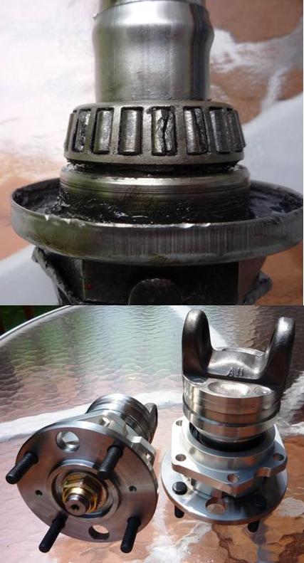

Gliderman8
Here's one more option for you.....
I ran into the same problem at the beginning of the season. The bearings in my hub were disintegrated beyond belief!
TRF wanted $299... Good Parts hubs were $349.
For me the $50 difference was a no-brainer. The GP hubs are much better. I would at least have a look at them before making the decision to rebuild.

DNK
I'm with Elliot on this . Might as well. Didn't even cross my mind.

Okay, I'm really liking the Goodparts hubs. Infact I think I'll go that route, but will those TR6 hubs work on my TR4A IRS? I think they will, but...? Anyone, anyone...?
Gliderman8
Good question... but I don't know.
Call Richard Good at Good Parts and ask him if no-one else responds.
<span style="font-style: italic">edit: Moss list the same part number for their hub for the TR4IRS AND the TR6 so I'm thinking the GP hub will fit.</span>

HerronScott
Hubs should be the same. I do seem to recall that the splined section of my TR4A half-shafts had a threaded cap which kept the splined sections from separating which the TR6 half-shafts didn't have, but that shouldn't matter with regards to the hub.

boeingpilot
boeingpilot
Thanx, Scott. After referencing 5 different shop manuals I came to the same conclusion. I'll confirm this with the Goodparts folks before pulling the trigger.
boeingpilot
boeingpilot
Quick update. Talked to Richard Good this morning, and his TR6 hubs will work on my TR4A. Thanks for all the info, gentlemen. I may still try to engineer my own hub puller though, just to see how it turns out.
