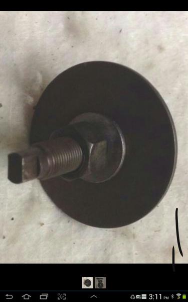

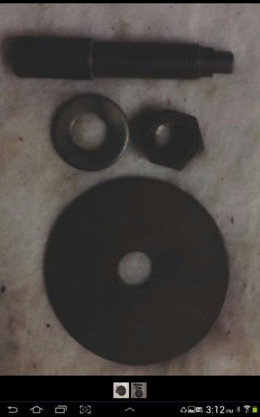

To get to the cotter pin and the castellated hub you will need to remove the grease cap. To remove the grease cap you need a grease cap extractor. There is one on ebay for sale
