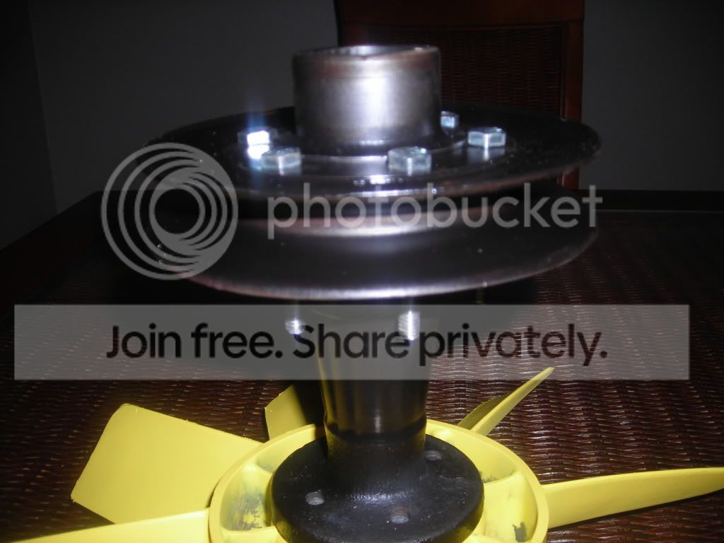

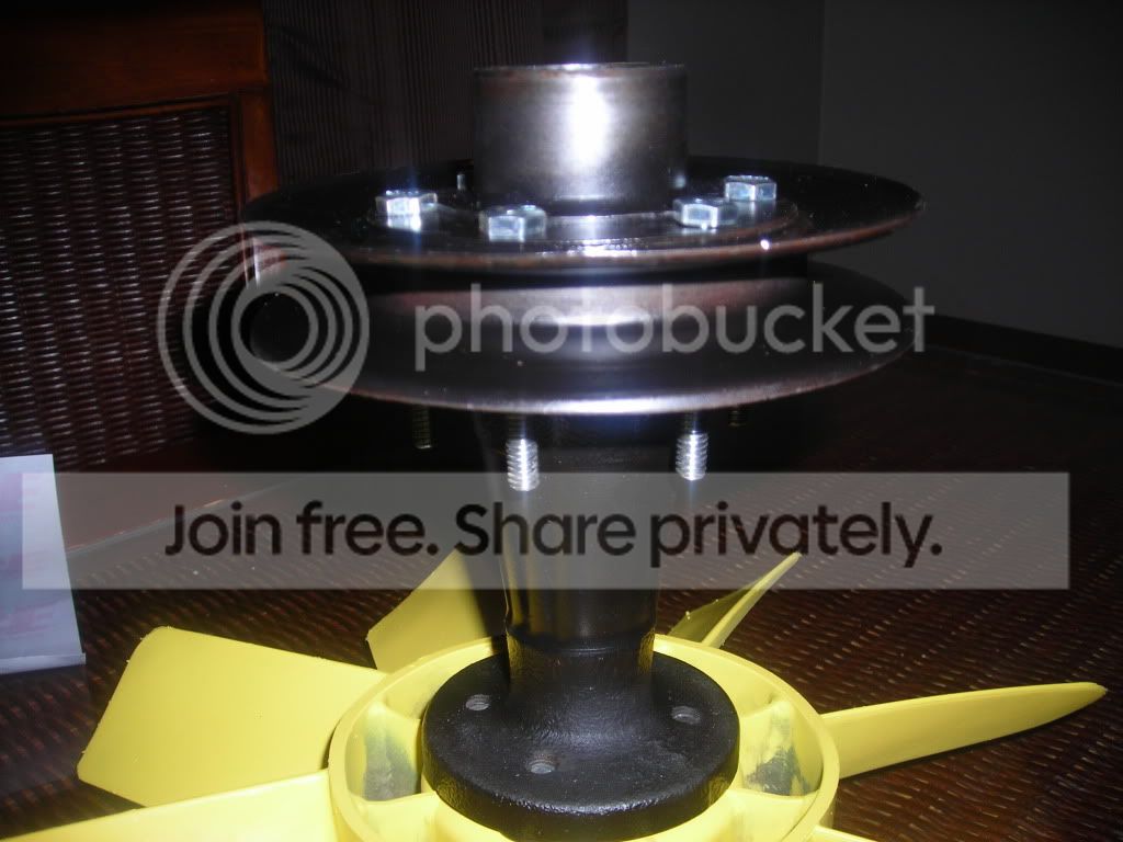

Just for clarity, note that #75 should be assembled with 76 and 77 (and 71 if you're using it) before installing the assembly on the motor. Don't forget the orientation between 75 & 77; there are 6 different ways it will go together but only one is correct.
One more question - assuming the bolts used should have shank the same depth as the metal parts being assembled. Nylocks nuts or conventional lock washers and nuts, or does in not matter?
I need to trim the bolts still...

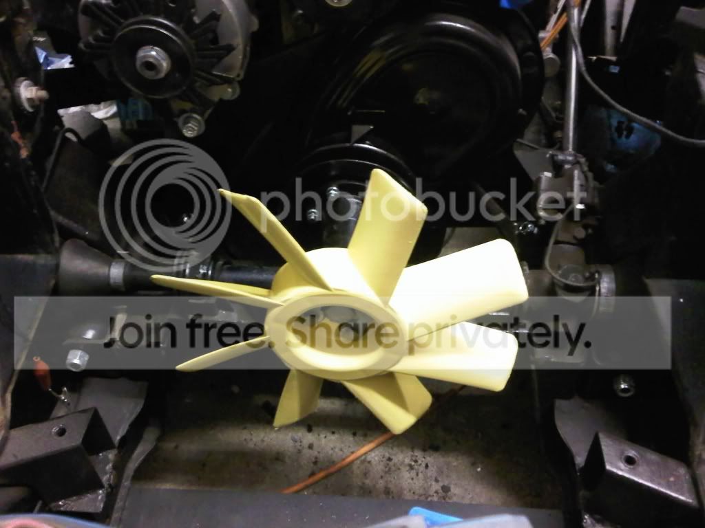

Still need to bend the tabs over on the fan bolts, but nice to have this installed finally. Thanks for the help guys!
