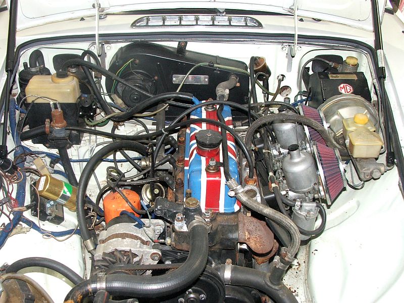

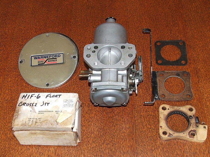

As I commented on a different bulletin board, the HIF6, HS6, or HIF44 is a direct bolt-on replacement for the ZS175.
I ran an HIF6 from an Austin Marina on the combo intake/exhaust manifold of my 1978 MGB for several years.
The HIF6 is basically the same as the HIF44.
It was a bolt-on conversion, other than the need to run a manual choke to the cockpit.
Performance was OK....it was the manifold that restricted the system.
I've since switched to dual HS4s
