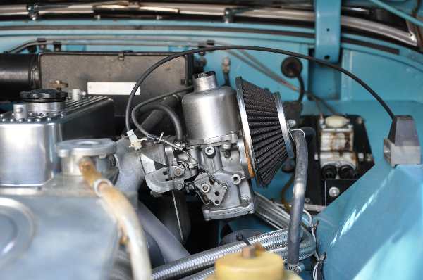

My fuel line is routed that way. A small clip was added to the air cleaner to keep it in place.

David,
Very neat!
I'll have to do something similar.

Copper tubing is considered a no-no on brake and fuel lines. Copper wear hardens with vibration resulting in cracks and failure. You'r o.k for a little while, but I'd switch to steel. Better safe than sorry.
Kelly, I can see the concern over copper where it is supported at one or both ends in a rigid compression fitting. If the copper is secured at each end by rubber fuel hose would the same fatigue issues occur?
I've seen quite a number of brake line kits that are some form of copper-nickel alloy. I assume it must behave more like steel.
Kellyguy,
Thanks for that observation.
As Doug pointed out it might be OK if both ends are supported by rubber hose - the connecting piece for the HS6's on my TR3 is a big loop of copper tubing (as supplied by The Roadster Factory)
Next time I'm at the auto store I'll pick up some steel tubing though.
