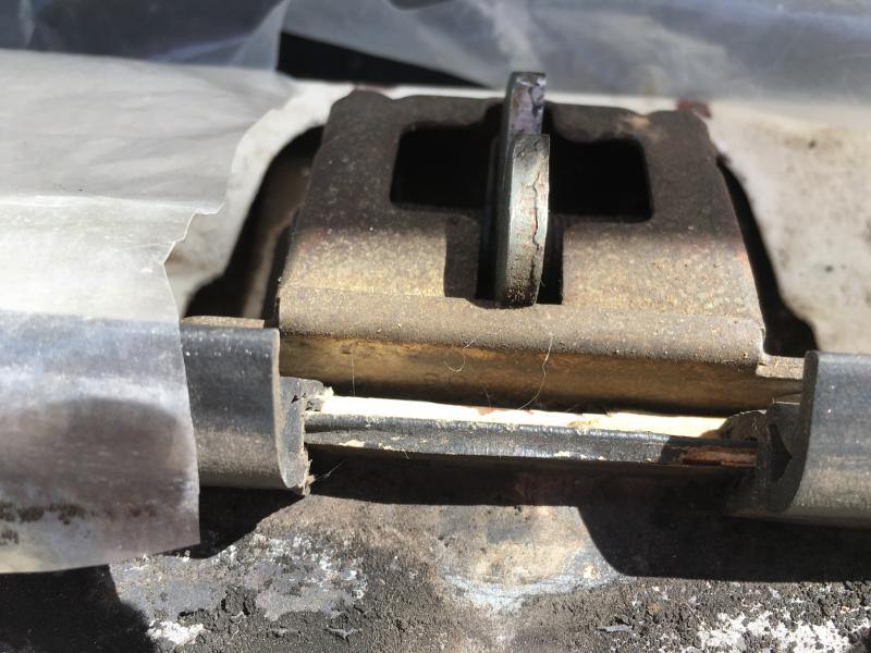

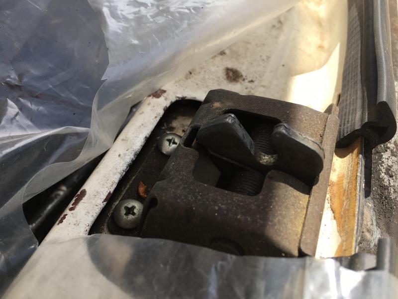

Russ, I think this is what they call between a rock and a hard place. I've included a couple of pictures. The latch has to move to the rear to release. It might be that the spring has broke which would keep the latch from coming back. Unless somebody else comes up with a different idea, you might try this. Drill a small hole above the button release angled upward toward the latch. Bend a short hook on a wire such as they use on model planes and see if you can't hook the latch and pull it back. If it works, all you would have to fix is the small hole. IMG_0085.jpgIMG_0086.jpgI should probably add that my lock also quite working, the key just went around but wouldn't lock or unlock the lid. But it would still open by pressing the button. After seeing how rusty the spring was I'm going to replace it before I have the same issue.

Not a bad idea Terry. I basically knew that I had to get that "Hook" portion pushed back but just had no idea how!?!
I'm out of town & will be back tomorrow. I'll see what your suggestion does Terry.
