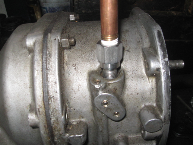

Right, no other place. You need a gauge adapter that fits in place of the control valve plug. There is no NPT hole on an A-type (unless someone added one). There's a photo on page 2-305 of the TR4 workshop manual.
A J-type has a plug just for the gauge, but even it isn't NPT.

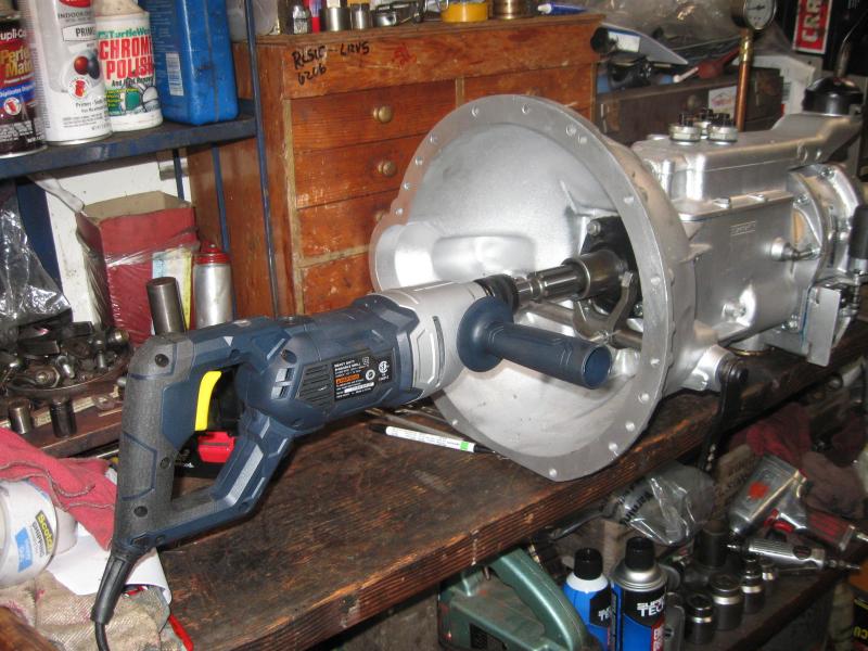

Heres a picture of how I test atype overdrives
Philstr6
Phil
attachment.php
attachment.php

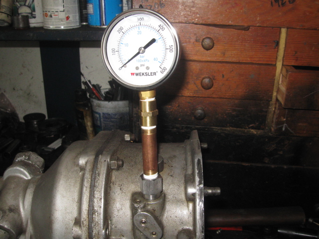

Heres a picture of the gauge in the overdrive
Phil
attachment.php
attachment.php
attachment.php
Note that the $50 to Jay includes the oil filled pressure gauge. Nelson reported that a non-oil filled gauge died pretty quickly, so the oil appears to be important.
