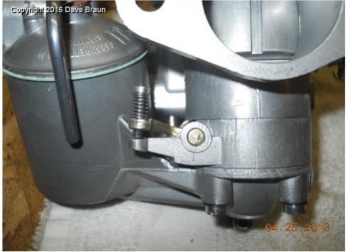

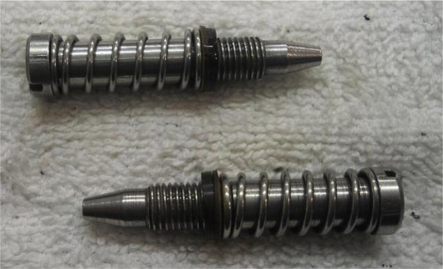

I intend to have a go at cleaning up the HD6 Carbs on my 1961 BT7. I rebuilt the carbs two years ago and they work fine. However, each time I look at the carbs I wish I had spent more time on the cosmetic appearance. I have been inspired by Dave Braun's beautiful work of a pair of HD6's (https://www.dbraun99.com/SU_Carbure...bly/slides/09 jet and initial setting 11.html) and two images below.
I have set up a small soda blaster system which I intend to use to clean up the outside of the bodies (followed by a bit of polishing), but what can I do to restore the small screws, spring, throttle linkages etc. Were the screws originally chromed or zinc? How do you think Dave cleaned up his screws and springs?

I believe that you will find that most hardware on out LBC's is zinc plated. A couple of years ago I researched DIY zinc plating at home and have been pretty successful at cleaning up and plating the original hardware. The pieces on the carbs are numerous and small and take awhile to clean and plate but the results are worth the effort in my opinion.

I bead blast all of the hardware from each carb and then hang them from pieces of copper wire. I then dip them into a cup of acetone and let air dry before putting them into a solution for plating all the while wearing latex gloves to keep oils from my fingers off of the parts to be plated.
Search the web and you will find alot of information on zinc plating. I use a solution of vinegar, karo syrup and epsom salt that has had a strip of zinc dissolved in it. Then use electrolysis to transfer the dissolved zinc to the parts that you want plated.

Hi, seeing you are in Hampshire UK I would recommend you send or deliver all the parts to Dorsetware in Poole Dorset. They are indeed zinc plated, Dorsetware will perfectly refinish the parts at very little cost. I've been using them for over 20 years for all my metal refinishing from zinc to chrome and never been disappointed with quality or price.

Hi I'm just outside Bere Regis. Your carb parts need zinc and clear passivate.

What did you do with the carb bodies? I have polished the dash pots but not sure how to finish the bodies.

I have access to an aqua blaster which carries very fine media in water with compressed air to blast carb bodies. It gives a smooth dull lustre finish which doesn't fingerprint as badly as vapour blast. A rub with a fine scotchbrite pad after blasting can give a somewhat patinated look.
I've used the finishes above on lots of alloy and mag alloy parts during my 911 restoration works with great success. It's possible to have alloy parts Chromated to try to hold back corrosion a little but I only do that on the magnesium alloy parts .
Andy
