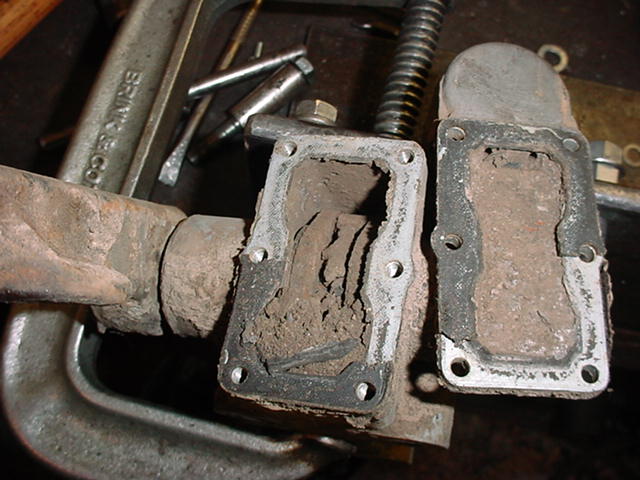

The front shock fill plug accesses the air chamber and IT has 2 rather small holes that drain into the body of the shock. It can take a looooooooong time to drain into the shock. There shouldn't be any oil in the air chamber. If you are topping up, take your time. Luke pumped oil in and the chamber filled so he thought he was done. He wasn't. These 2 little holes allow oil into the shock but they also have to allow the air in the shock out while filling with oil. It's not like filling a differential that has a big hole. As I've cautioned before, you also don't want to overfill the shock.
I'm going to try to post a picture of Jack Laird's shock he sent in. The lid is removed revealing what may become oil in a few million years, but is dried mud now. Look at the inside of the cover and you'll see the 2 holes. I hope this works. Peter

If my shocks looked like Jack's, I'd be in the market for new ones for sure /bcforum/images/%%GRAEMLIN_URL%%/wink.gif Mine look new. They are painted black and the problem with them is they've just been sitting, doing nothing for the past 18 years.
Oh gesh, that's awful. I did replace or have Peter replace both. No leakes here.
