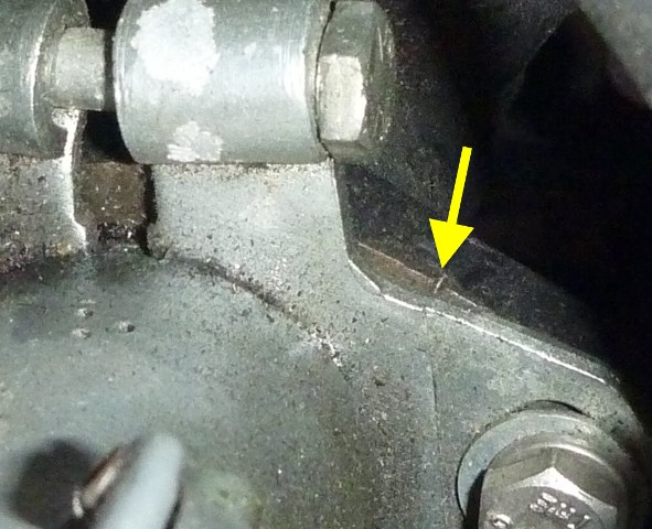

Index marks can be helpful helpful between the distributor base plate and the block - for removing the distributor and gapping the points on the bench.
