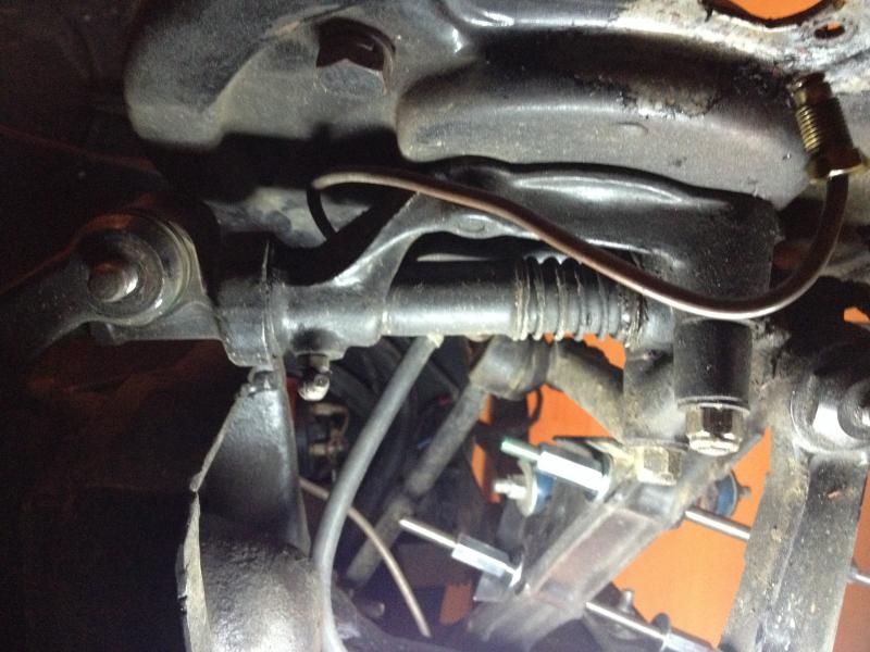

1) According to Fig. L3 of the manual the washers are ordered as follows: a staybrite washer, a olive washer, another staybrite washer. The order of the washers in my car looks different: two thin washers followed by one thick washer (see picture).
2) According to the manual should be able to lift the swivel axle including the hub assembly. Unfortunately the backplate of the drum brake hits the lower portion of the swivel pin (see attached picture). Thus I am not able to lift the swivel axle. Do I have to remove the complete hub assembly and the backplate from the swivel axle now? Inparticular removing the hub assembly seems to be a lot of (complicated) work.

IIRC ("if I recall correctly"), the bronze/olilite thrust washer should be between the two silvery staybrite washers. Also, the staybrites come in different thicknesses--or you can use shims--to set the end float of the swivel axle. Since it appears your suspension was assembled incorrectly, I'm wondering what else the DPO ("dreaded previous owner") might have done, and did he cause/contribute to the other problems you've had?
Can't help with the trunnion/backplate fouling as I haven't done a drum frontend in a while, but it sure looks like you have to remove the backplate. As the bushes in the swivel axle will need to be renewed and reamed, you will probably have to do this regardless.
Volker,
I removed mine a couple of years ago for my front disc conversion. You'll probably have to fit and ream the new bushings that come with the swivel pin kit. They will need to be reamed to size by someone with the special reamer.
Therefore you'll need to disassemble the hub, bearings, shims, brake drum, brake hose, backing plate and steering linkage from the swivel axle. Then it'll be "easy" to remove.:smile:
Do you have access to a British mechanic or machine shop?
