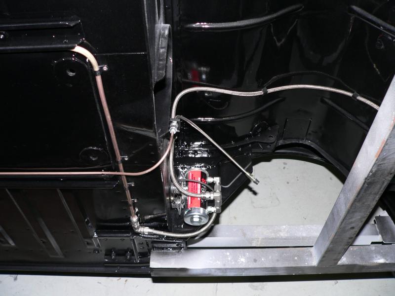

This is an old picture of my Bugeye, but you can see the bolt holes behind the passenger seat. I used 2 longer bolts and rubber grommets to mount and isolate the pump and it works well. Choose grommets that aren’t too hard and a good piece of adhesive backed rubber or sound deadener between the body and pump helps.

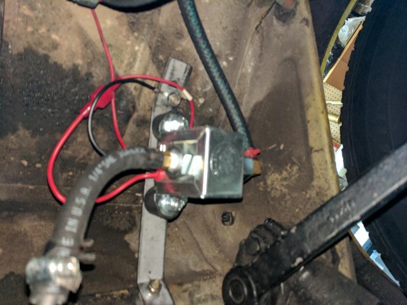

I have a fascet on my 50 BE. Passenger side. Bolt between the two halves of the rear bulkhead assy.
No insulation or anything, I want to hear it running. When engine is on I cannot hear it but that is just my exhaust system.

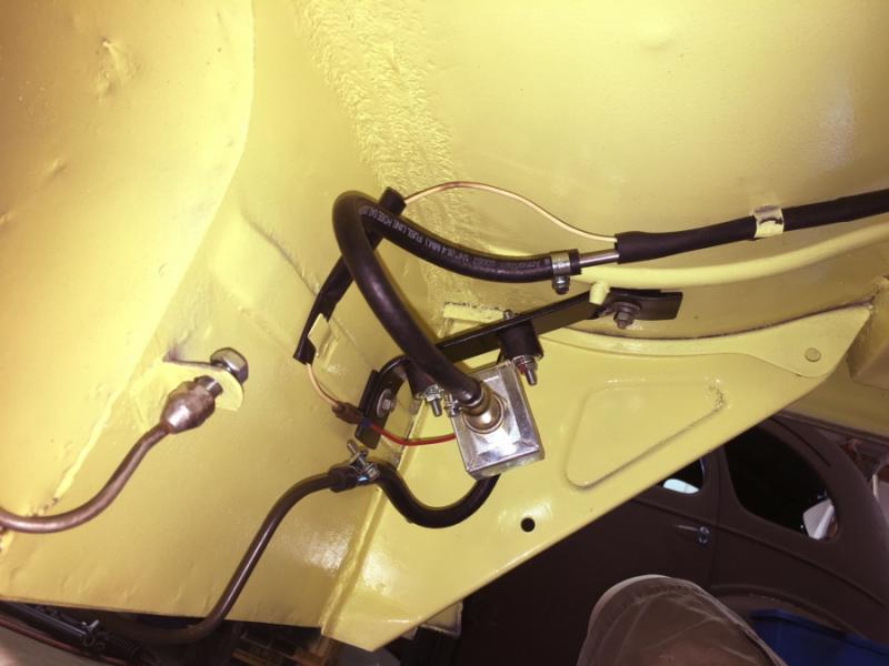

If the '67 is the same as a '74, there are two studs for mounting the fuel pump. One is on the sheetmetal that is 90* to the bulkhead. You can make a mount out of a piece of flat stock and mount the pump to that. I did that temporarily while waiting for the SU to be rebuilt. And, if the noise bothers you, you can mount it with rubber isolators. Sorry for the bad picture. Although, that rivnut tool looks pretty cool!

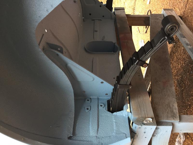

BlueMax, your looks like a beautiful engineering job. I finally went a little simpler along the lines of 74MGMidget. Built a bracket using the original studs and ordered some rubber mounts from Amazon. Here it is.
Yes, I forgot to get the photo until removing it from the rotisserie and had to crawl under for this one.
