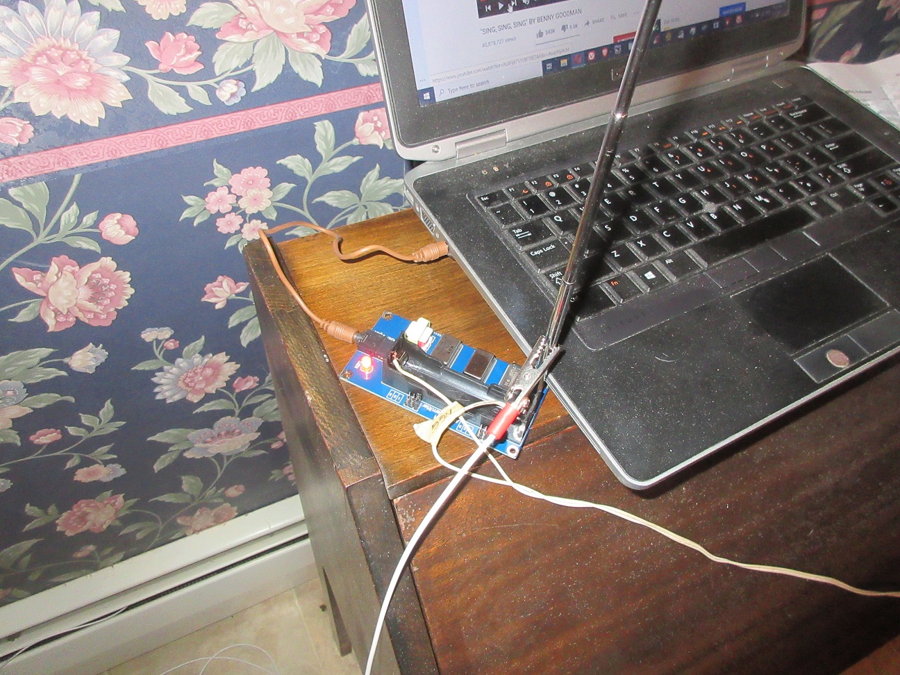

Update: just received that 1-3-5 Mhz adapter. Works perfectly!
I'm using a battery replacer transformer instead of the 3.7v battery required.
Nice to have a way to play laptop audio to the 1930 AK-74. thanks for all the advice.

What's the alligator clip on the antenna for?
Thanks gents. Leave it to me to try extending the life of ancient tech!
The transmitter's included antenna (18" high telescoping) is wimpy, so I wired it to the hydronic baseboard radiator. Now the whole house is an antenna for the tiny adapter.
