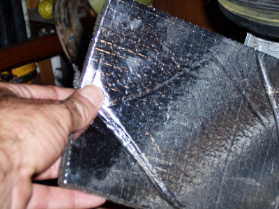

As far as insulation, I would recommend, (soon to be installed in my car) an insulation for marine engine-room applications. It is approx .5" thick and made of three layers, dense foam, rubber (Dynamat-type) layer, mirrored mylar quilted layer. It is a little pricey (as is all marine stuff), but is effective for both heat and sound insulation. It will also make a nice, padded carpet underlay! It cuts easily with an Exacto or utility (razor) knife. $50-$100 worth should easily do a Spridget!
Thanks Mike. Looks like what you have there is foil covered on both sides? I found a similar product through Advanced. One product has foil on one side and felt on the other. The second is foil covered both sides.
