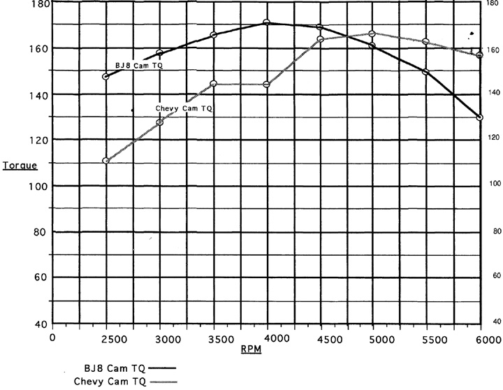

Well Dave, you seem to have a very good grasp on cam design, or the same engine simulation program I have. /ubbthreads/images/graemlins/grin.gif I ran some numbers and came up with what you have already said. The best results look to be a BJ8 cam with headers up to 4500 RPM. At that point the Isky cam w/headers starts making more power followed closely by the Chevy grind w/headers. The torque curves tell the same story.
[/ QUOTE ]
Hi Greg,
I don't have the program. Just 45 years of experience studying & building high performance engines & a good engineering background. Thanks for the very good illustration. Since torque is what you feel when you drive on the street, torque makes the most noticeable difference in acceleration. OTOH, horsepower is what creates top speed which is seldom needed. I converted your numbers to torque to better illustrate the point. I just compared the two cams without headers. See attached.

Hi Ed,
Unfortunately, the big power gains are out of the reach of the motor’s livable RPM range, unless you sink some serious money into. /ubbthreads/images/graemlins/cryin.gif
Great info that really helps. I would appreciate if the BJ7 cam performance can be added to the graph. It would ease decision making for me. Can performance with the BJ7's stock 1.75 inch carbs be simulated? I assume with increased exhaust flow and performance that carb settings must be richened. Any comments?
Hi Stretch,
Here is the BJ7, BJ8 and BJ8 w/headers. I have tweaked the CFM slightly to reflect the peak HP @ 4600 for the BJ7 and 5250 for the BJ8. Looks like about a 7 horsepower increase from BJ7 to BJ8 w/headers to 3000 RPM. From there the gap increases. The BJ7's torque curve starts to drop earlier, it looses ground near the 3000 RPM range whereas the BJ8 w/headers doesn't loose umph until 4000. Please keep in mind that these are ballpark figures. Having flow bench numbers would increase the accuracy of the simulation. But it isn’t the real world. /ubbthreads/images/graemlins/cryin.gif
