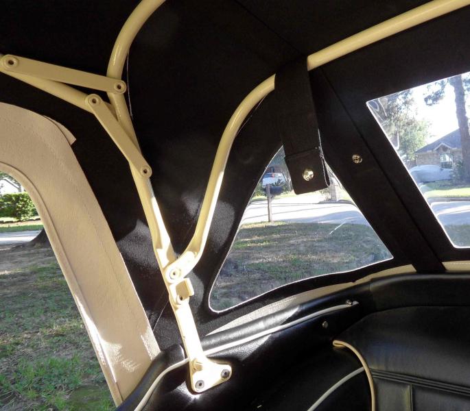

My painter painted my hood stick assembly with the proper body color but NOW it is pretty stiff and in need of some lubrication at the joints for ease of movement. Any thoughts on what to use? I was thinking that some sort of lithium grease would do the trick but would like to get your thoughts on this.
I know I have to work them to get them loose enough but feel that some sort of lubrication would be in order.

I painted mine and managed to lubricate it enough to move. I think I used silicon spray but felt the issue would be too much movement (and rattles) rather than not enough. I was concerned about getting it tight as well as finding/starting the threads into the threaded plate thru the inner panel/material. The holes in mine are tapered to allow a countersunk screw/bolt, so I got some longer fine thread Allen head screws. Both screws thread into a single plate that allows some movement, until tightened. I seem to recall having an even longer bolt to hold the plate into position so I could start the second screw. I think an Allen head can be tightened much more than a flat or cross head screw. It must be countersunk so the hood stick can swing past it when going up or down.
