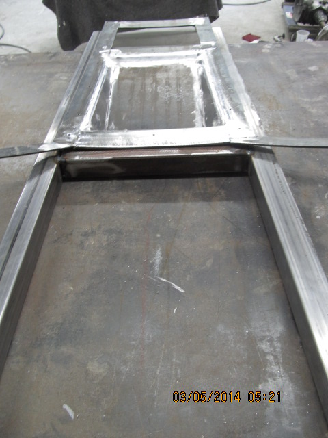

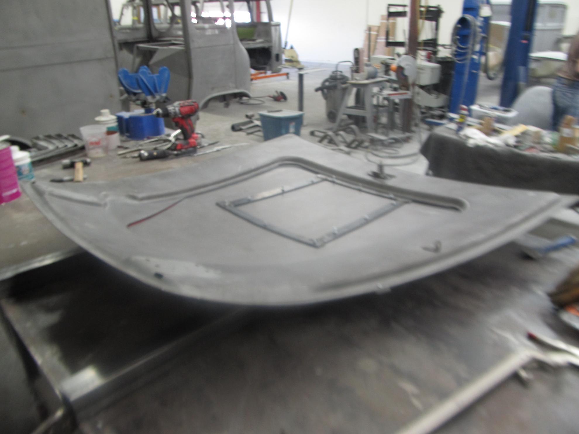

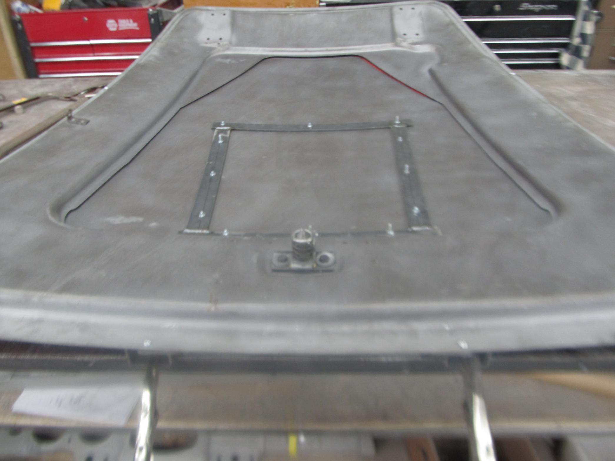

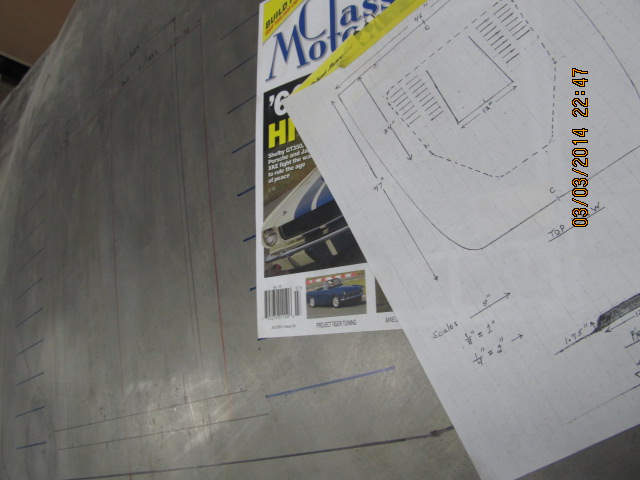

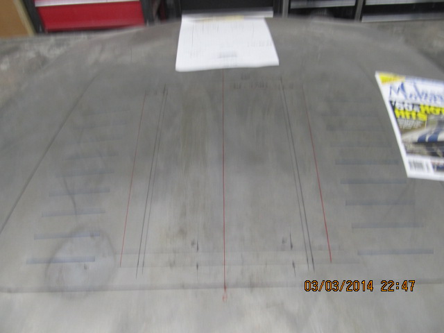

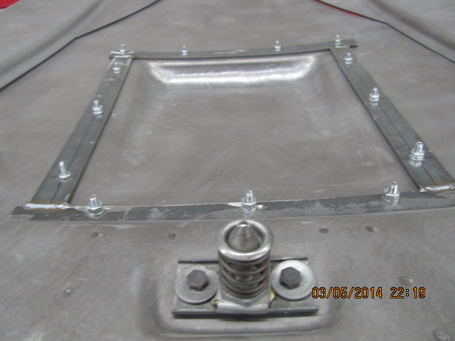

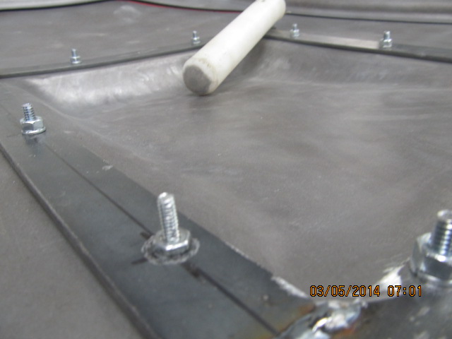

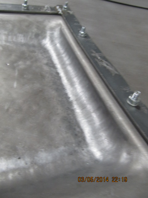

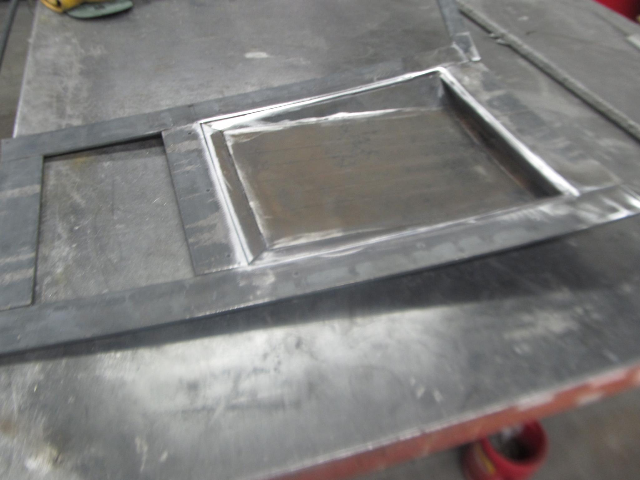

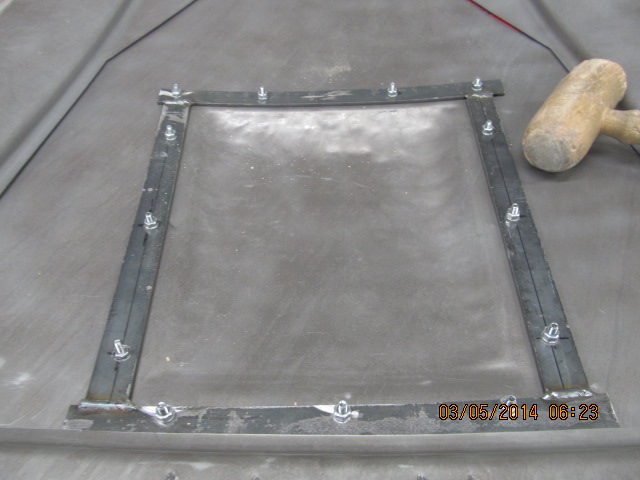

Making a hood scoop for a Tiger hood without welding the body of the scoop in.First pictures of the metal jig being made followed by 'chasing' the material into the 'jig'.
More pictures to follow.
