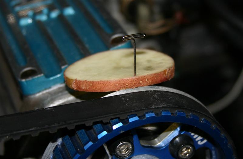

You say poetaytoe I say pahtahtoe . . .
Did you measure how far above the "p&-'tA-(")tO" the T-pin extends?
Added the thickness of the potatoe to the height of the T Pin above the potatoe . . . AFTER closing the hood of course. :-)
I normally use a blob of modeling clay. I once had a young engineer going nuts trying to figure out the clearance above the core support on a GM pickup prototype. He was trying to devise some measurement system using indicators, LVDT's, etc. He even was talking about pulling the engine and having a technician in the engine bay with calipers.
I grabbed a stick of clay, put three pieces on the core support, sprayed some WD40 on them, and slammed the hood. Popped it open again, and showed him his clearances. Quick, simple, and accurate.
