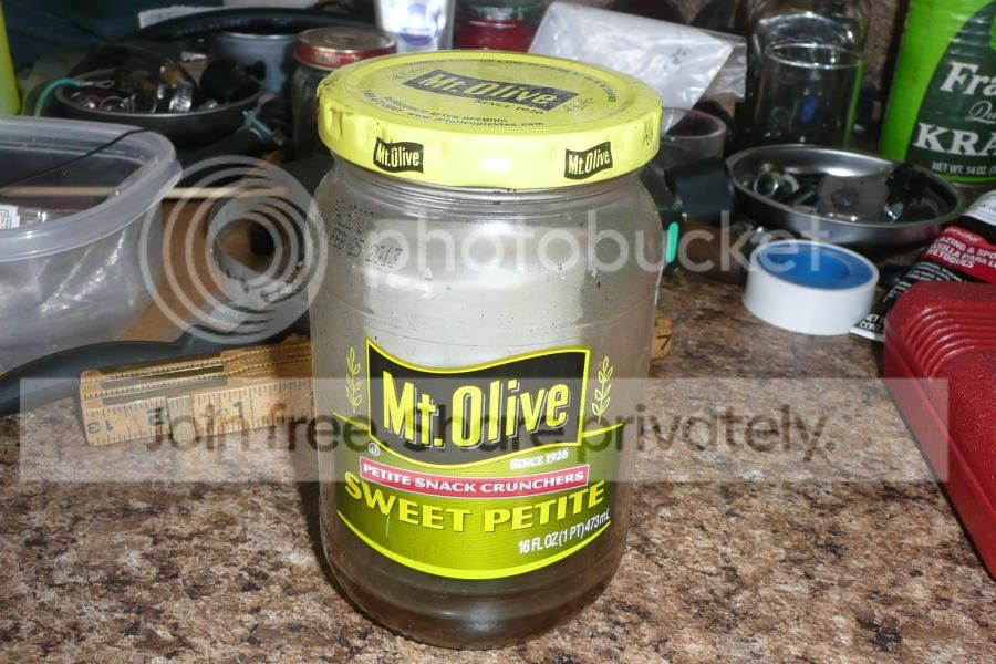

The manual specifies the use of a 'clean pickle jar' so that, of course, is what I use.
