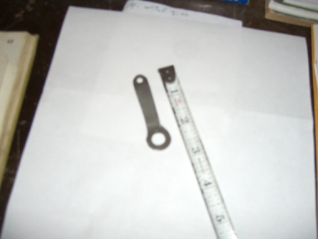

I made them out of a small piece of stainless steel flat stock. They are small and easy to make and they tighten the whole system up. Without them, I could wiggle the bowl easily. There is only about 2 psi of fuel pressure there, so the rubber does not have to be very tight; the problem is that vibration starts cutting into the two pieces of rubber as it shakes from the engine running. Perhaps TRF has them for the tr2.
Is the length such that they support the bowl "as installed"? IOW, does the bowl sag a bit (as it compresses the rubber washers) when you disconnect the brace?
Also, any idea what thickness of stainless you used? I don't suppose it matters much, but most of what I have around looks to be quite a bit heavier than yours.

I made them out of stainless sheet metal somewhere between a 1/16 and 1/32. Stainless is a hard metal and holds it form pretty well, but again they are thin. Anyways I bolted the bowl up tight and then bent them with pliers until they acted like a brace on a parallel plane that fits on a screw on the dome and the one on top of the bowl. I drill the two holes in a larger piece for work ability and then trimmed it down for looks.
