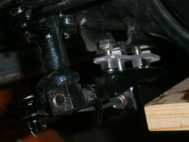

Make the emer brake work really proper. Like all the old cables mine has stretched and over time I have done all kinds of things to make it work properly. Well at the last car show I was telling Rut my prob and ding, I had a solution. So here ya go.
The bracket, hand brake support needs modified to accept the longer cable. so just cut the support in half near the front end and weld it back together about a half inch longer. Now the adjustment threads will work just fine. The distance between the mounting holes and the threaded hole needs to be longer for the stretched cable. Really. Hope that made sense.

The ferule is a good idea jim and I considered that but it means removeing the entire cable and all that entails. I now have the bracket that attaches to the rear axle with two bolts out and.... would like to update my first comments.
It is the large end that has to be extended. The one the cable goes into and through, has a slot for the cable so the large end can go through the hole and on back.
Maybe the easy way would be to drill a couple of new bolt holes so the bracket would move forward about a half inch. However that means that the screw end the one with the threads would need to be extended maybe to clear the rear of the axle, will check that soon as I cool off. Wouldn't it be nice if only a couple of new drilled holes fixed the problem. More later.
Ok is now later, drum roll please, wait for it, Drilling two new mounting holes fixes the problem, you would need to add a few washers to rear hole to make up for the tapered part.
Orrrrr, drum roll pls, how about a flat peace of steel with four holes, two to mount the plat to the axle and two to mount the bracket to it in its new forward position??
There you have two ways to fix the problem one that requires no changes to the car and one that does just a bit. Your choice.

Made the plate out of alum. bar stock I just had on hand. Drilled the holes and hit it with a grinder to get rid of rough edges. Painted black so no one would notice it when in place. Need some stainless bolts, will get em and install. Will report on final result.
Plate in and bracket in and attached as well. Has worked so far just as i had envisioned. Now need to adjust hand brake. Will advise further, darn cement floor hard even with card board on it. Later.

All done, works fine, three clicks of the emer brake to lock as specified. All newly painted with stainless hardware.

Really sorry about the poor pic. not much to see nor a way to really show after it is done. Guess I should have taken a pic before I put it in.
Gave it a shot or two with my favorite, black rustoleum. Now looks like it belongs there.
