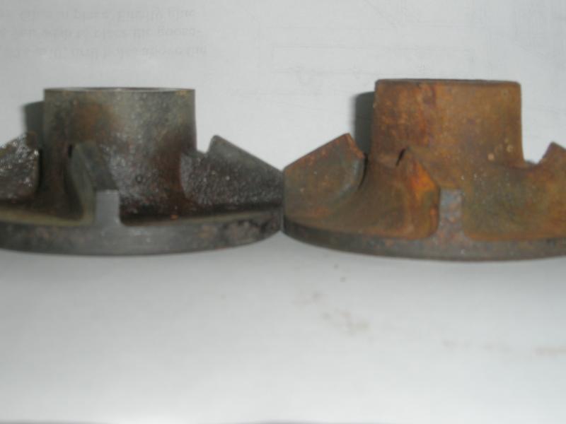

I once had a MB 450SL that I replaced the water pump with an aftermarket one. After installing it, the car ran fine at city road speeds and stop lights. When I took it on the highway at 70 mph, it ran much hotter than previously. Long story, short, I found out that the clearance with the impeller to the pump body was much greater on the aftermarket one. The gap was noticeably different when compared side by side. Replaced with MB part and problem was solved.
After researching further, the consensuses was that the pump would cavitate and become inefficient in flow at higher speeds. Cavitation becomes worse as the temperature of the fluid approaches its boiling point. As the car ran slower, less heat was generated and the flow was enough to bring the temperature away from the boiling point, thus eliminating the cavitation.

Been away on vacation, Thought I would check to see if there were any new suggestions. You brought up an interesting point. When I rebuilt the engine, I noticed a significant difference in impellers between the replacement water pump and the original. Since I plan on taking the radiator out, any suggestions on where to buy a new pump?

attachment.php
fyi, here is a pic of an original (right) and a re-pop impeller. Note thicker base, and fins not as high. I estimate maybe 2/3 of discharge area in the re-pop. Note that this re-pop had to be from late 70's, not the current vendors.
