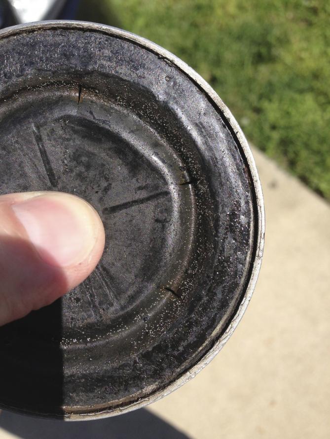

3 Updates:
#1 - Block test turned out OK (the one where the blue liquid turns green when combustion gasses are present in the coolant). So it seems like my head gasket is fine.
#2 - High oil pressure. I double-checked my oil filter installment and apparently I had put an extra o-ring in it without seeing the old one still stuck up in there. :applause: When I started it and ran it to do the block test, the pressure was back down to ~70-80 cold. That's more like it. I had also cleaned out the pressure adjusting apparatus, but decided to just put it back in as it was and didn't make any adjustments. Glad I did.
#3 - Got my PCV valve, opened it up and noticed some small cracks (3 in the picture and one under my thumb) in the diaphragm:
I'm going to order a new diaphragm but in the meantime, I'm just going to clean it up and install this as-is anyway. This weather is just too perfect!

That's probably a good idea. And I can justify the cost because my PCV valve was apparently free! I contacted the seller through eBay telling them about the cracked diaphragm and asking if they could send a replacement. Thought it was worth a try. Well an hour later I get a full refund, no questions asked. Never had that happen before!
