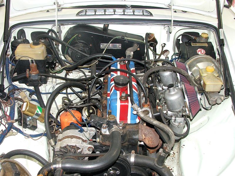

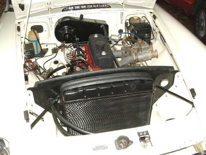

I dont remember the model Doc. But the make is Weber. I went out to look at the carb but other then the made in spain stamp and a few weber stamps, it has no markings. Fuel leaks out the bottom of the air filter. On a closer look the fuel comes from behind the filter housing where it meats the "throat." Out side of that, the swap worked well for me.
Will, if it is a side-draught Weber, it should have the size stamped in the top cover: "40 DCOE ??" That's not a common setup, but the best one IMHO.
Float level may be wrong, needle may not be seating ~or~ there's too much fuel supply pressure.
This is the DCOE on Mitsy's B:
