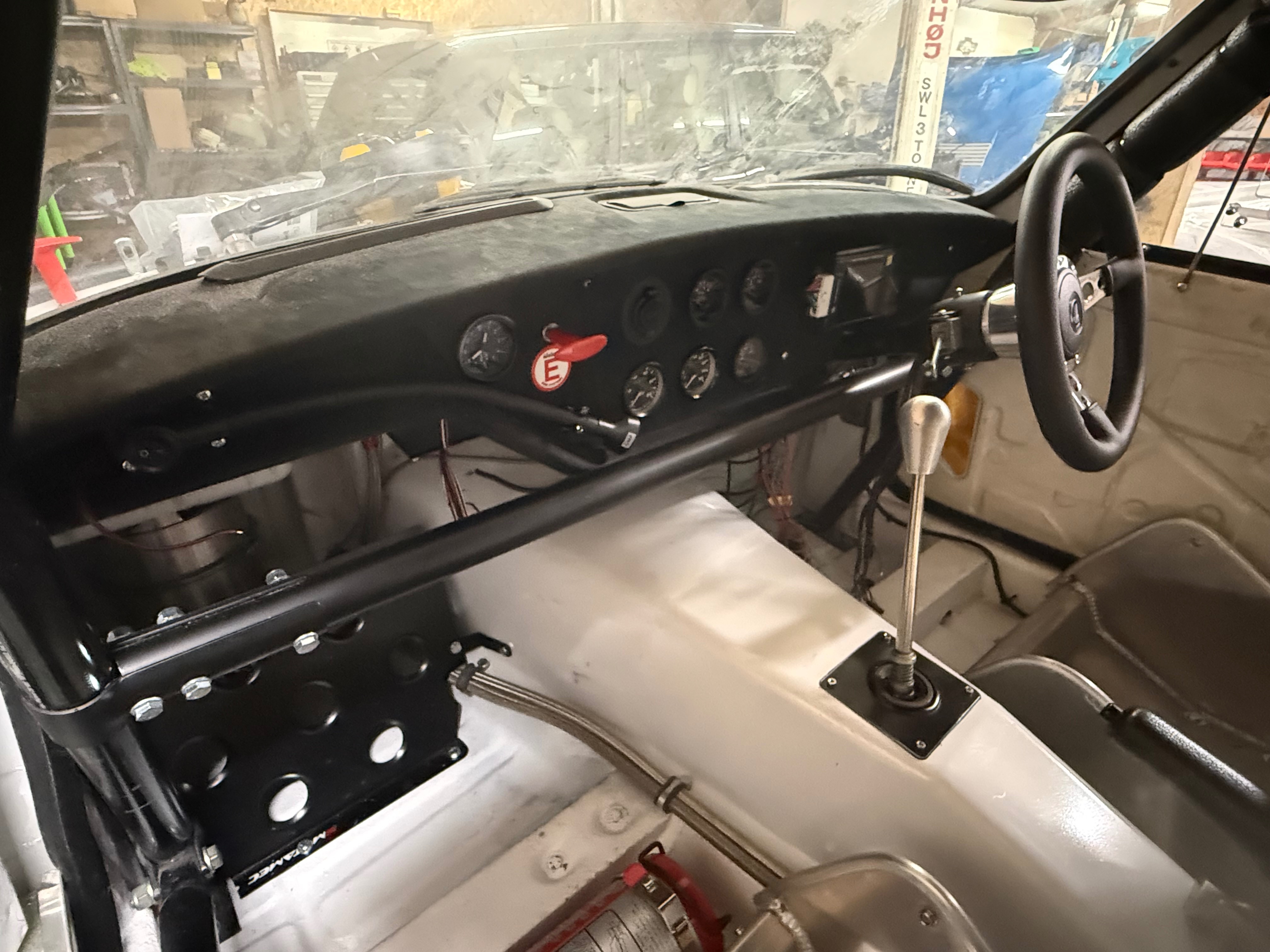

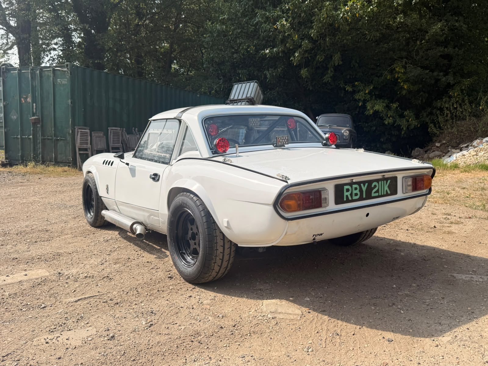

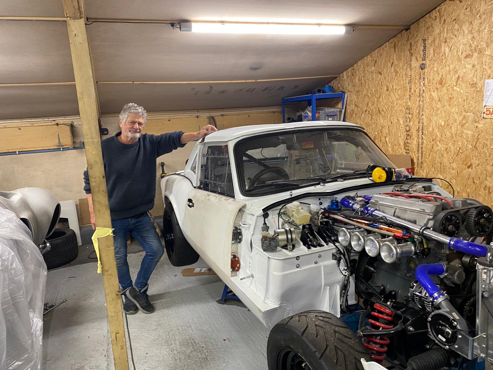

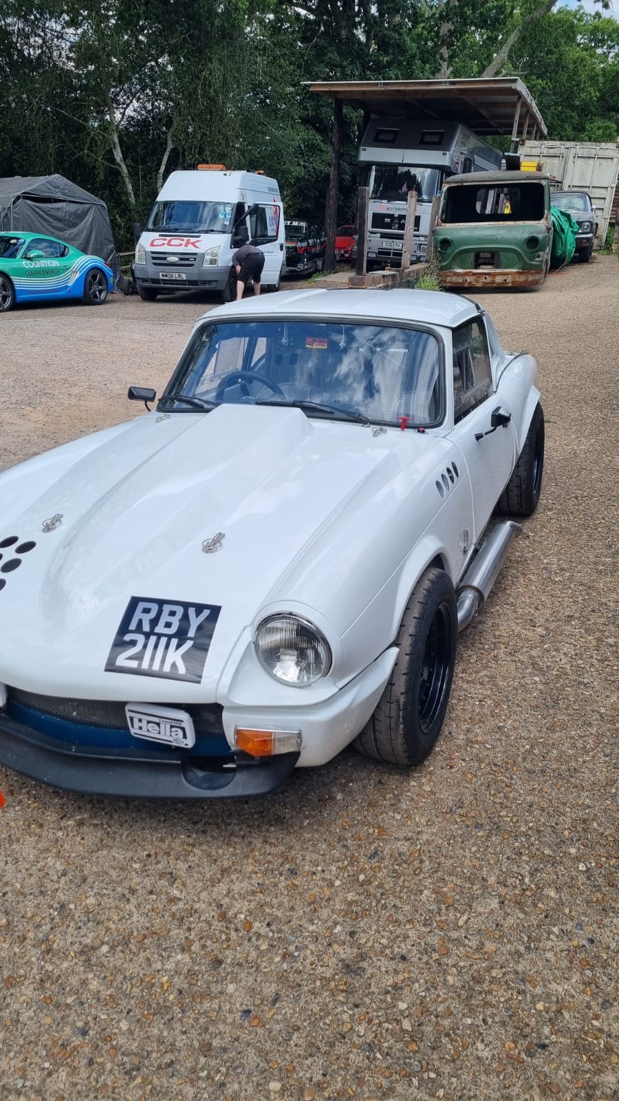

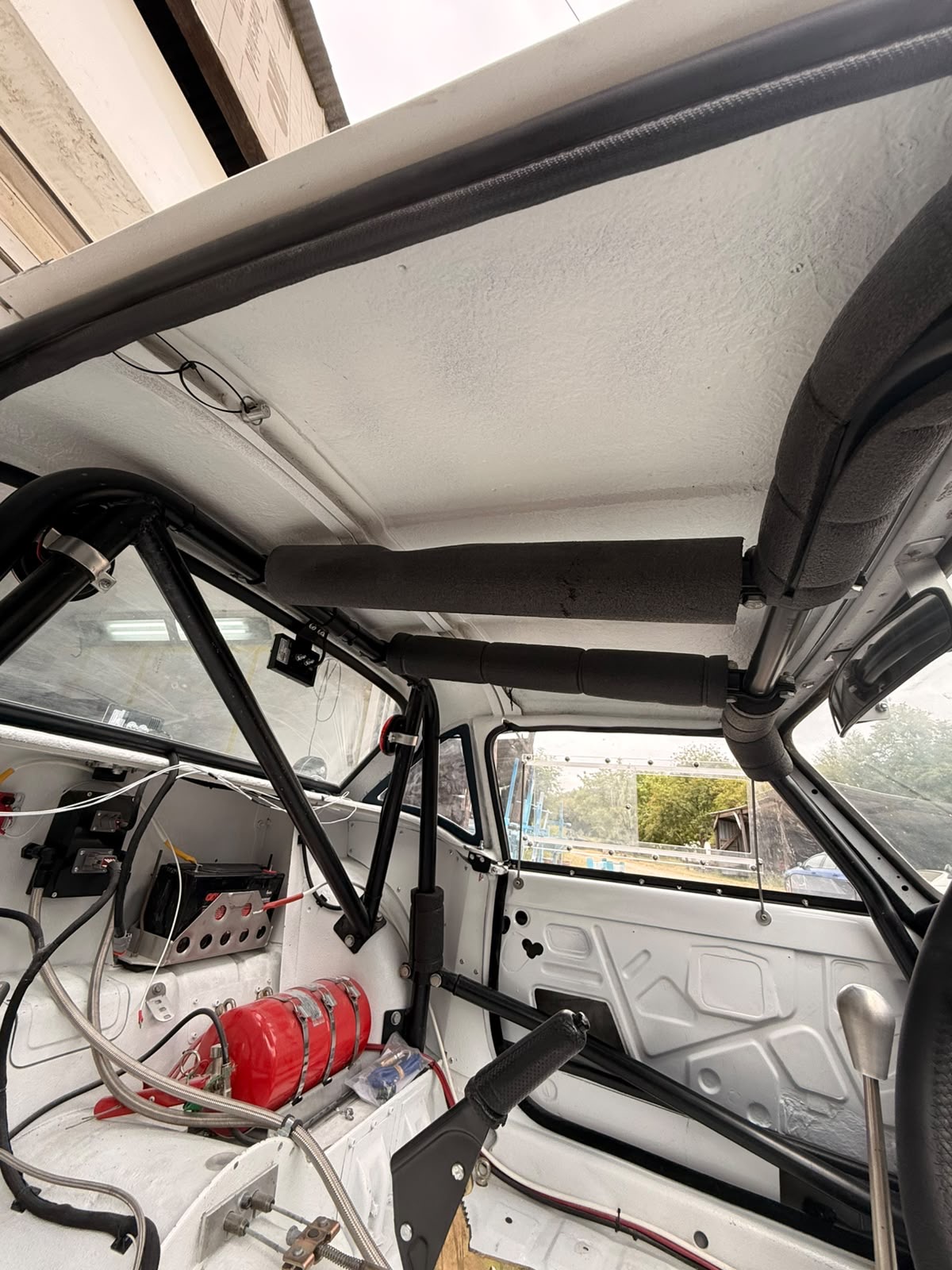

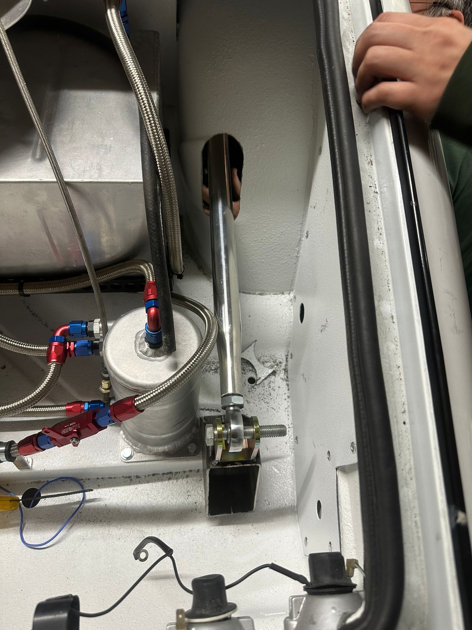

Hi , over the past 5 years I have had my lightweight road/race 1971 Spitfire built .
It should be going on the rolling road in the next couple of weeks just in time for 7 months of winter . Shame .

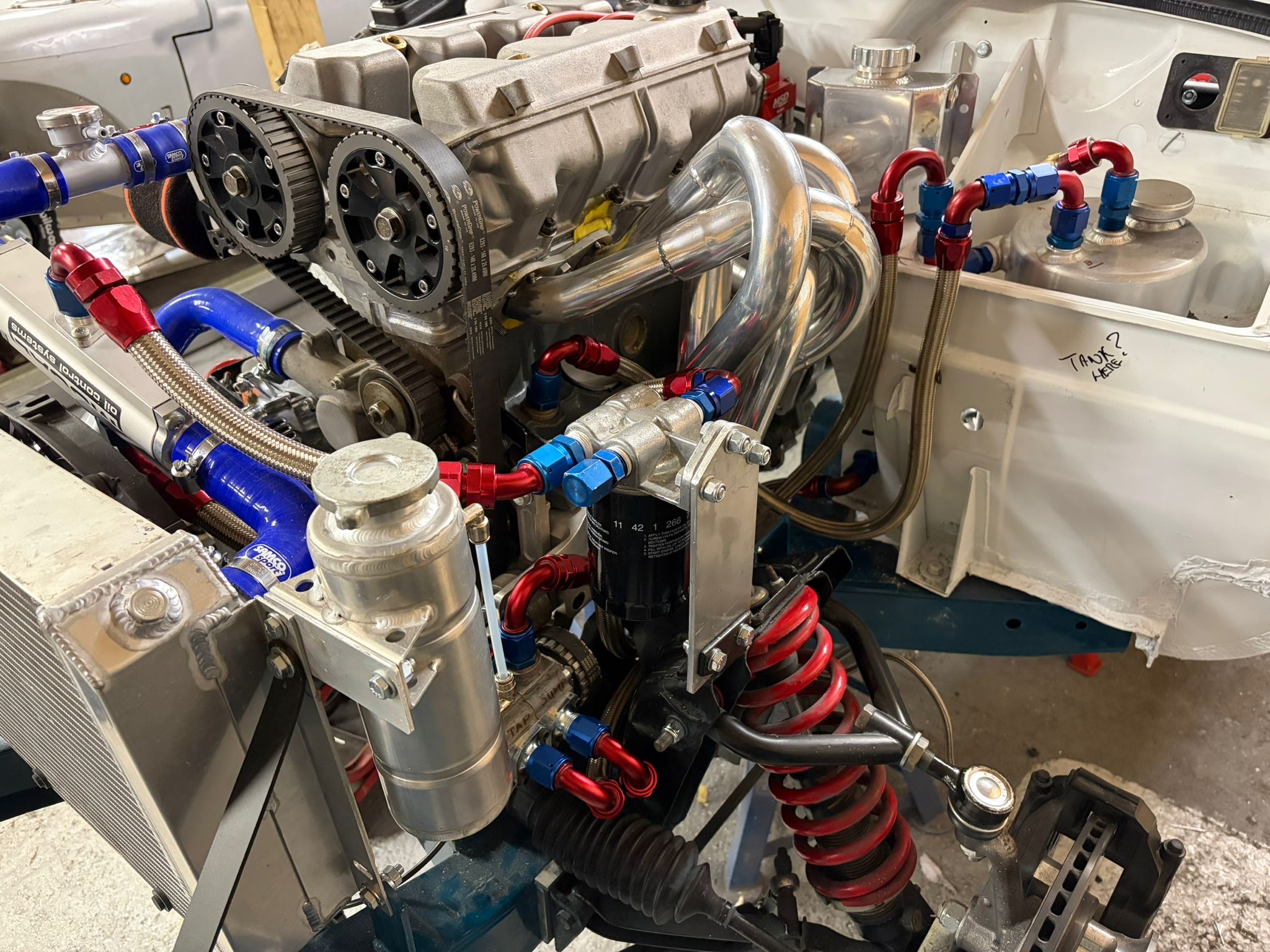

It is powered by a 2.0 Fiat/Lancia twin cam from the same period . However the block/crank was new old stock , in fact nearly every part of the car is new so it is really a 0 miles car . The engine runs individual throttle bodies controlled by an Omex ECU . The head is a worked big 8 valve Lancia Delta unit . The rods are Arrow and the springs are ISKY . An Allison header leads to the side exhaust . The dry sump was designed by Guy Croft and the pump was purpose designed by Titan in Cambridgeshire .
A lightweight flywheel holds a twin plate cerametalic Tilton clutch . An aluminium TranX ( Quaife ) Ford type 9 is linked via a Guy Croft adapter plate . There is a choice of two Subaru R160 differentials both 4.11 , one is fitted with a Quaife ATB the other a Kaaz 1.5 way .

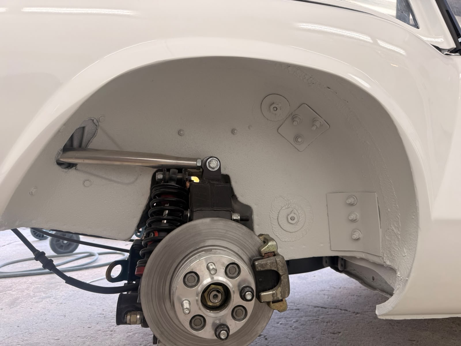

The rear suspension has been redesigned with a lower A arm and a tie bar upper system. The rear corners are all MGF and the front corners are all Caterham .
The cooling is via a Davies Craig electric pump and controller and a Caterham radiator .
The bonnet , doors , boot lid and targa top are all fiberglass . Seats are Kirky with SCHROTH 4 points .
There are aluminium twin fuel tanks in the boot .

A couple more .

Welcome to BCF. We'll have folks to advise on your work if asked - but I'm thinking you can provide us some advice yourself. That is quite a brake system!
