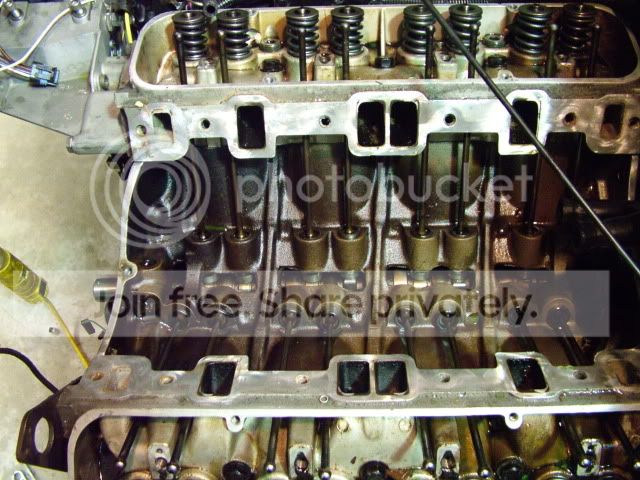

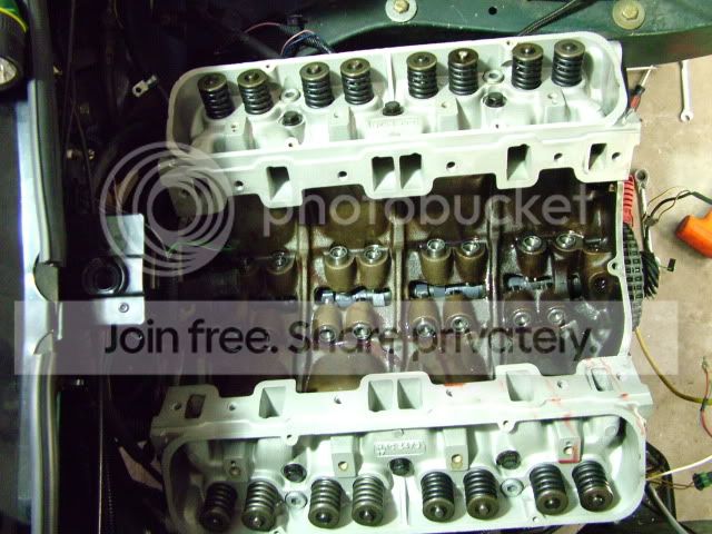

Geez Pics. Haven't you seen enough half dressed v-8s in your life time Paul?
Stripped with old heads
New heads on

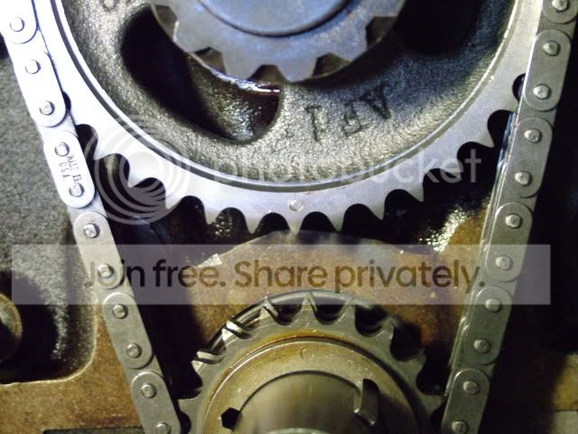

Timing chain installed

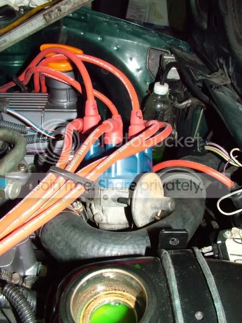

Not much, here a shot with all the stuff up front.
And here's a pre shot with all the stuff on.
Holy moley!!
Where does the radiator fit in there????
If you notice, carefully, this vehicle sports a prototype vacuum advance unit that actually plugs into the upper radiator hose.
Room up front?
Uh......no.
But, it all fits.

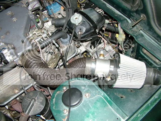

Hi Don. I had the oval foam air filters on my carb TR8 which pulled air from the immediate area in the engine bay. As part of my efforts to get her through CA SMOG I fitted the stock air boxes and the ducting that brings fresh air in from the vents on the far outside top corner of the front engine bay. Made a surprisingly noticeable difference in how she runs. I can post pictures when I get back.
Tom, Look at the tube in front. It does pull air from the front of the car.
Hi Don - saw that. Was just observing that fresh cool air made a big difference for me.
That air filter will still pull warmer air in from the engine bay BUT much less than a carb car will and I <span style="text-decoration: underline">did</span> see the air intake from the front of the car.
Usually a bit hotter down here than up where you are ;-)
