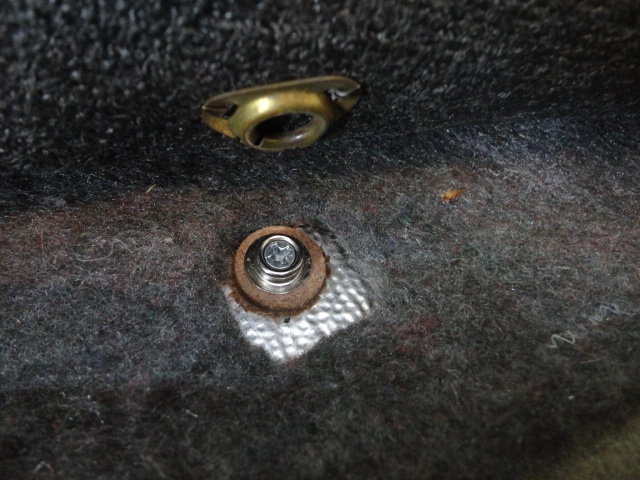

I also have a Heritage Carpet Set and Interior for my BJ8 interior. I installed the snaps in their locations with spacers for the jute so that the Carpet wouldn't have any dimples. I used a hole saw to make the spacers, pics shown, and cut out the Jute where the snaps are and I did not glue the Jute to the Carpet or to the floor. I did it this way so that if I need to change the clutch or remove the Carpets, etc., everything comes out easy. If Carpet and Jute are wet they will also dry much faster and this decision is from experience of owning my Healey since 1972. Most likely you'll have to trim the Jute anyway because Heritage makes their Carpets and padding a little bit oversized.

I used the masonite tempured hardboard but any spacer will do such as a non-rusting metal, etc. I did not glue the jute to the carpet because it's much faster to dry them both when they're separated. I also cut out the slots in the rear carpets for the seat tracks so they easily come out if they get wet. I added a few more snaps to the trans carpet than it originally came with to smooth it out for a better fit.
