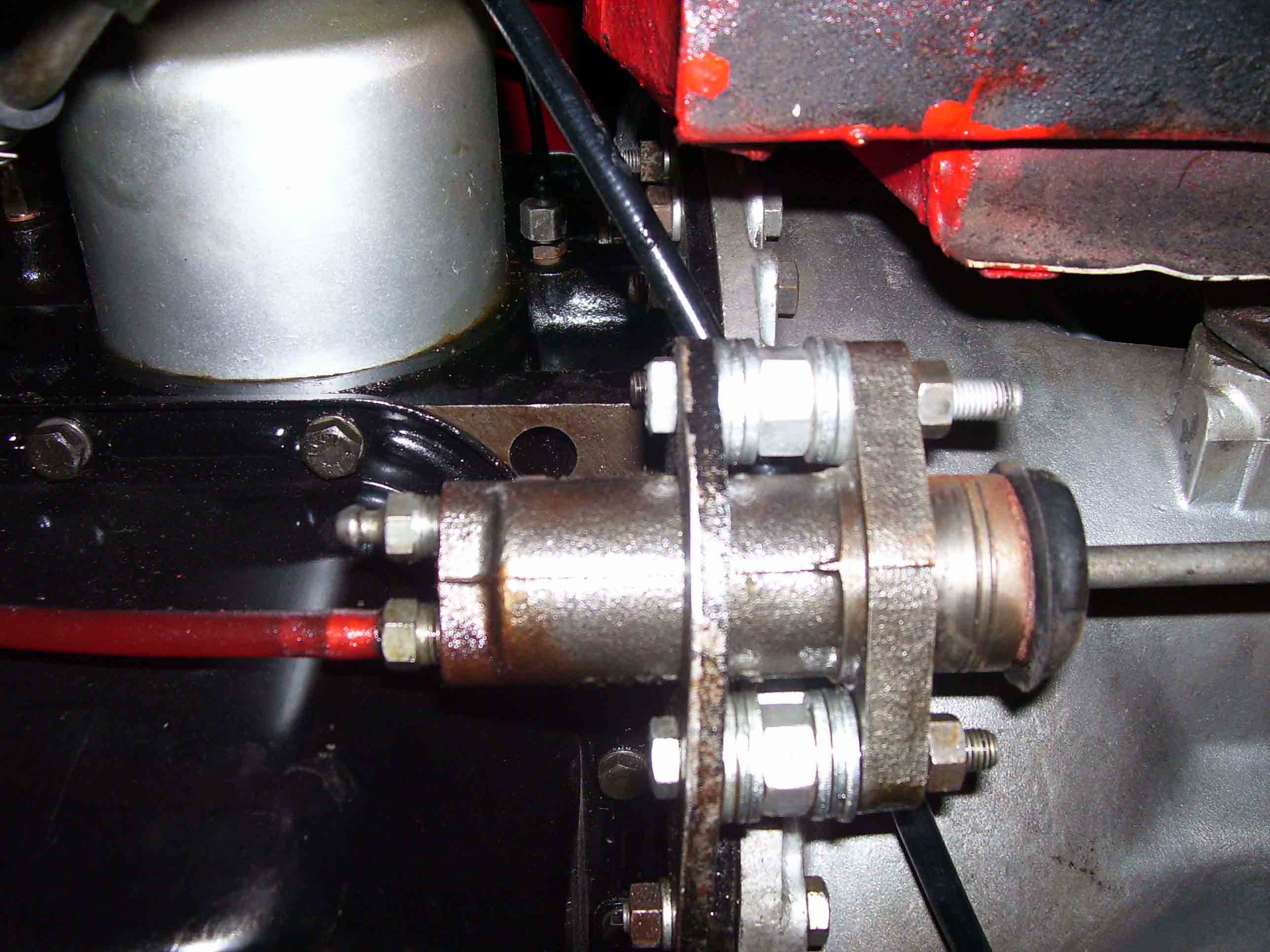

Can anyone see anything wrong with this picture?

That's one way to get a little more throw on the slave cylinder. /ubbthreads/images/graemlins/jester.gif
I scrolled down but not over. I was sitting here thinking what's wrong? Nothing.
Now I see!
This will make a great PO story some day. No lock washers, a square nut on one end. Where did you get this picture? Alabama?
Maybe that is a picture of Brosky's old clutch setup. Ya think?
Bill
It looks just fine, but the lower bolt is shorter than the upper, which may lead to difficulty in future adjustments, via the bolt and washer method currently employed.

This shot was taken by me yesterday morning here in God's Country (Alabama) HOWEVER, Let it be said that this car has just made the voyage down south from Upstate New York. This little modification was made by a Yankee.... You can tell by the lack of Bailing wire and/or duck tape.

I did that exact thing myself. That third hole in the throwout arm was not enough to get the clutch disengaged. Not sure if it was a master cylinder with .70 bore matched up with a slave of .75.... but it DID work just fine.

I work on cars for club members and this one is for a good friend of mine. He drove the car and loved it but, didn't do his homework on her. This is one of the many things I've found wrong...with a $23,000 dollar car.
