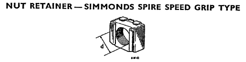

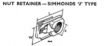

I've been trying to sort some dashboard wiring on the Herald and found the job much more suitable to my 71+ year old joints with the seats removed. The PO mounted them with bolts and washers with loose nuts underneath and unreinforced holes in the floor pan. I'm sure this is not original. It takes two people, or one with much longer arms than mine, to get them unbolted.
How were they done originally? Cage nuts? Nuts welded to a plate which is welded to the bottom of the floor? Studs welded to tracks? Other? Probably similar to Spitfire. Thanks in advance.

Tom, the seats originally were fastened down via cage nuts. They, and the metal into which they went, could be a bit fragile. But if said metal is all intact, then it's worth reverting to the correct fasteners. Somewhere at home I've got the part numbers, and all indications are that Canley Classics does indeed have said fasteners. Remind me here and / or e-mail me if you don't hear back from me fairly soon!
(NOTE: I did buy, via one of the part numbers, some fasteners from a US vendor, but they turned out to be something quite different and unusable in the Herald application. To their credit, they acknowledged the error; to my credit, they refunded my money! :smile: )

aHA! I didn't realize that Canley Classics actually had the bits listed in their online catalogue!
HU808SETSCREW - 5/16" X 1" UNF$0.36 USEACHIN STOCK8 (bolts to hold the seat rail to the floor)
FS2704RETAINER NUT - 5/16" NF$1.37 USEACHIN STOCK4 (Simmonds Spire Speed Grip Type -- front of rail)
FQ3406RETAINER NUT - SEAT TO FLOOR 5/16" UNF$1.52 USEACHIN STOCK
4 (nut retainer: Simmons "J" type -- rear of rail)
