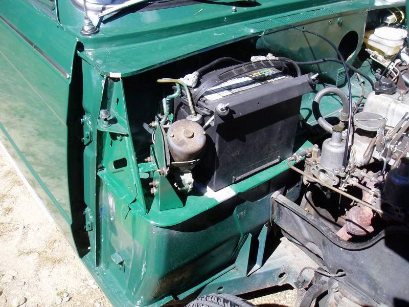

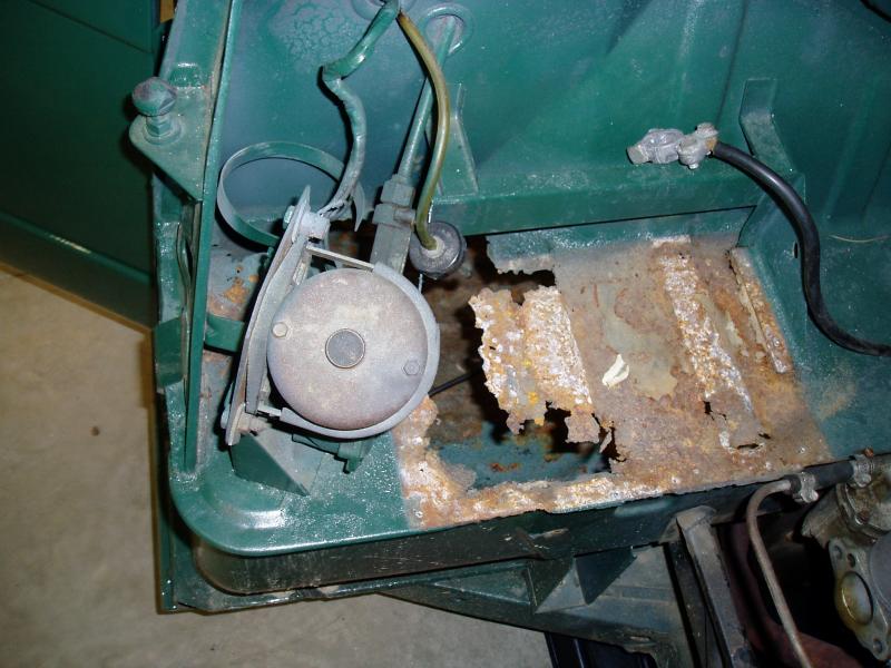

My wife complained that my non existent heater was turned on and burning her legs. Here's what I found under the battery which sites just above her lap (always look under the battery when buying an old car. I didn't:

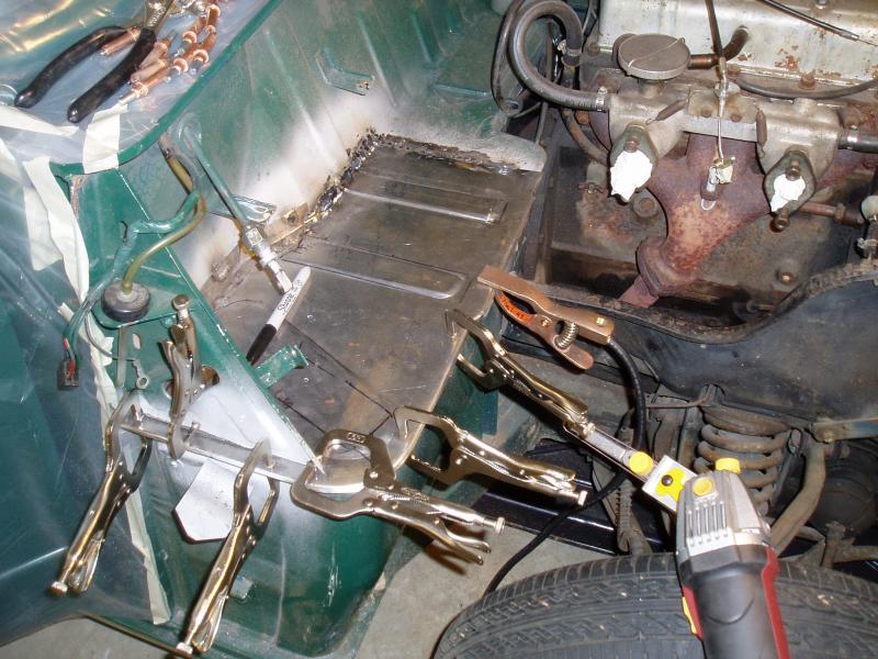

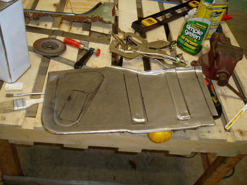

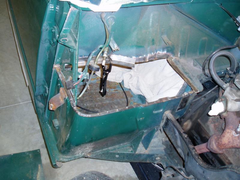

I could find no panels so had to make a repair piece.
Here's the patch in place,

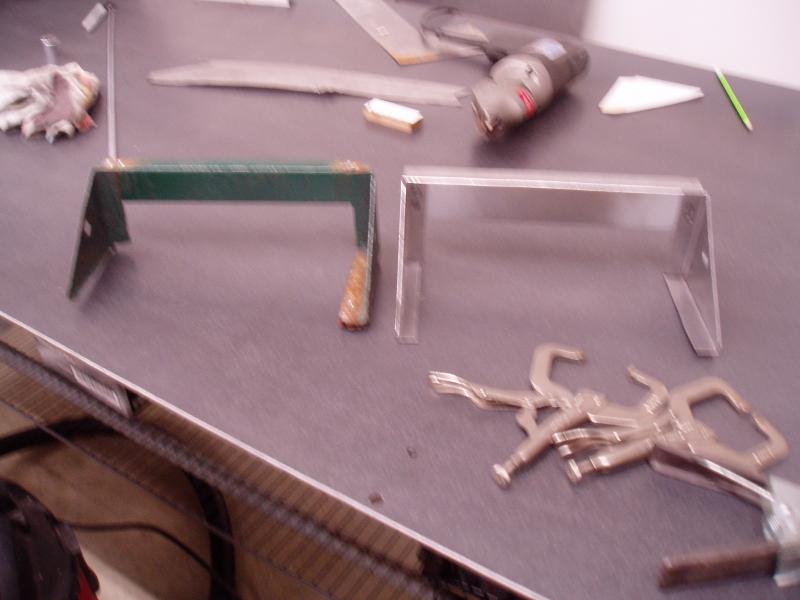

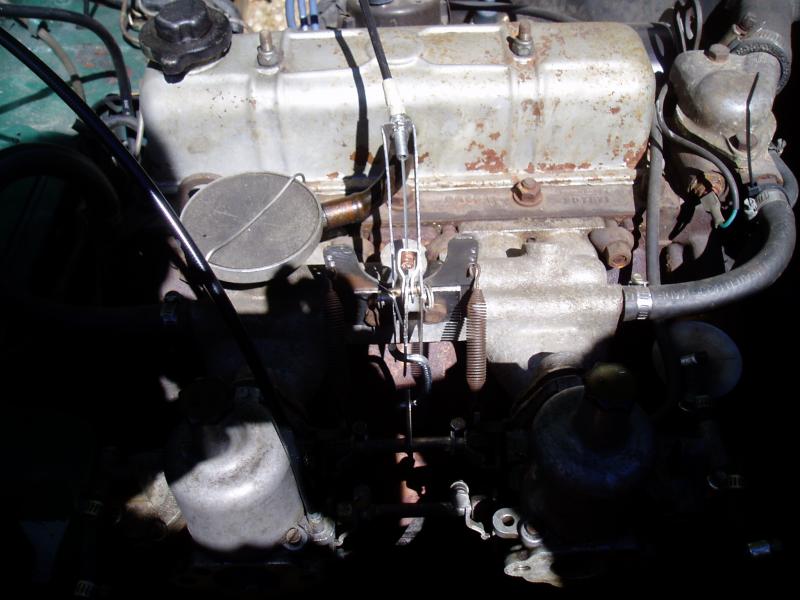

Here's the job I intended to do, the throttle linkage for the twin SUs. (I think they are original equipment on my Herald 13/60 from Belgium.
My thanks to Rhodyspit 75 for sending me the patterns.
Tom

Nice work, Tom! And yes, the SUs are original and correct. That particular car was built for the US market (sold new in Puerto Rico) and had to comply with Federal safety and emissions standard in effect at the time. The only "emissions certifiable" engine Triumph would have had at the time was from the Mk3 Spitfire, so that's what went into those few hundred Heralds built for sale in PR! (Triumph otherwise had stopped selling anything other than sports cars in the US market after 1967.)
