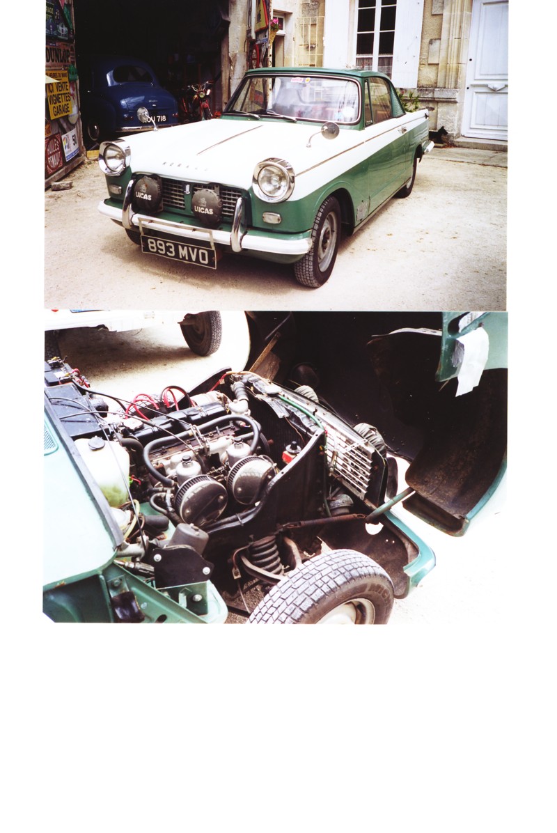

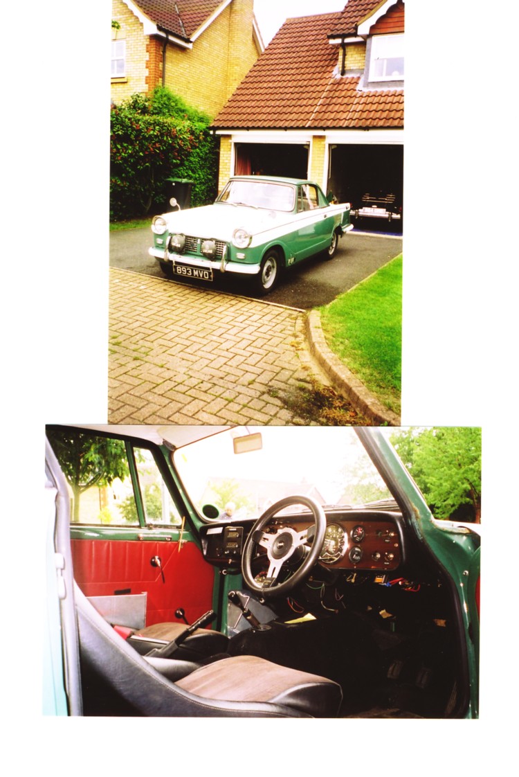

A couple of photos attached.

Nice ride Curtis. If I'm ever in France you'll have to give me a ride in it.
No pictures of the engine. the owner is going to send some but I suspect that I shall see it "in the flesh" first.Mind you it is not easy getting a place on the ferries at this time of year.Will keep you posted.

The top of the dashboard surround has worn and you can see patches of brown through the black.
Was thinking of painting it? What do you suggest? Bear in mind it is a competition car not concours,but it can still look smart!

As promised a couple more pics now that the car is back home in France.
The engine is 1300 Spitfire,gearbox also. At the moment I am not sure what is correct Herald Coupé and what is not. I imagine the alternator is non standard.?
