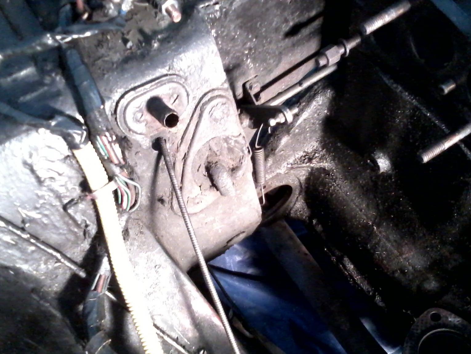

Anybody know what I'm looking at? Its on
left side of firewall if you were standing in
front of the Tr3.
It appears to be a severely rotted hose of
some sort.
Thanks

That is where the steering column would go thru if you had right hand drive. It could have been anything that the P.O. used a easy access hole.
Yes, it is the steering column hole for rhd, but on early 3A's it is made up of a metal blanking plate with a rubber gasket that accepts the drain tube hose from the air vent. There are 2 drain tubes - a short one from the battery box which exits straight down into the transmission cover, and this one which is quite a bit longer. Your photo shows a very well aged gasket with the end of the drain tube sticking out.
TRF part number for the longer drain tube is 602947, it's about 18-24" long.
Here's the new set up without the tube installed yet.
You can see the plate with gasket below. sorry, largest resolution pic I have:
If you are talking about the one coming straight out, that is a connection for a heater hose.
