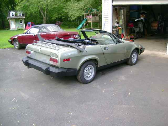

Unless you are looking to go thru the entire car, my advice is to stay away. You are far better off buying a higher mileage car that is driven and cared for. I have had 10 TR8s and at least another 20 TR7s. They like to be driven. They don't like to sit. You will go thru an amazing amount of money and even more aggravation trying to sort everything out. At the very least you are looking at new tires, a battery, a tired convertible top, rebuilding clutch masters and slaves, complete brake overhaul, fuel system and carb rebuild, and nine million electrical gremlins. Add to that, the car is pushing 30 years old. It will most likely have dried out seals, a weeping radiator, and ratty interior. Only buy a cheap fixer upper TR8 if you plan on highly modifying it and you are just going to replace everything anyway. I've been down this road twice, and I still can't believe I was dumb enough to do it a second time. A year and a half after buying my last fixer upper, I'm still trying to sort it out. I'm sure I'll find even more wrong with it once it hits the road. Here is a pic of my $2500 money pit.

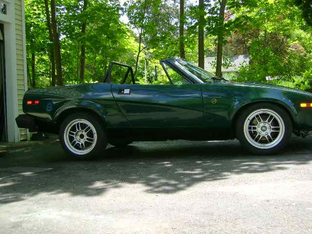

And this one started out as a $2000 gem.
