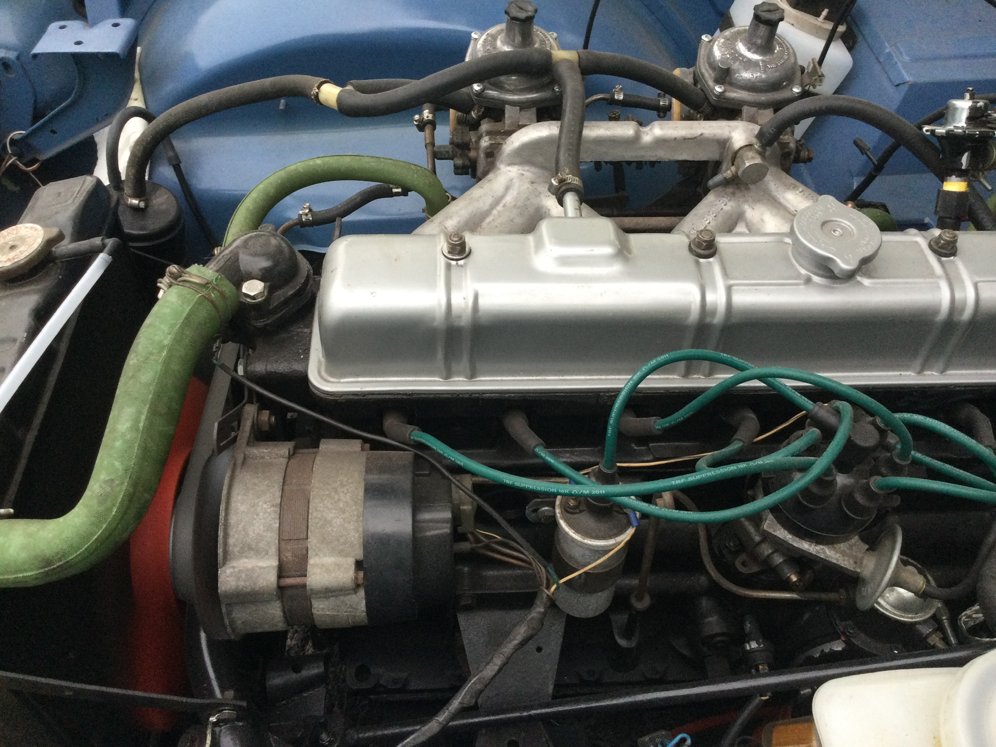

See if this video will play
Dennis - that's a photo (jpeg), not a video.
